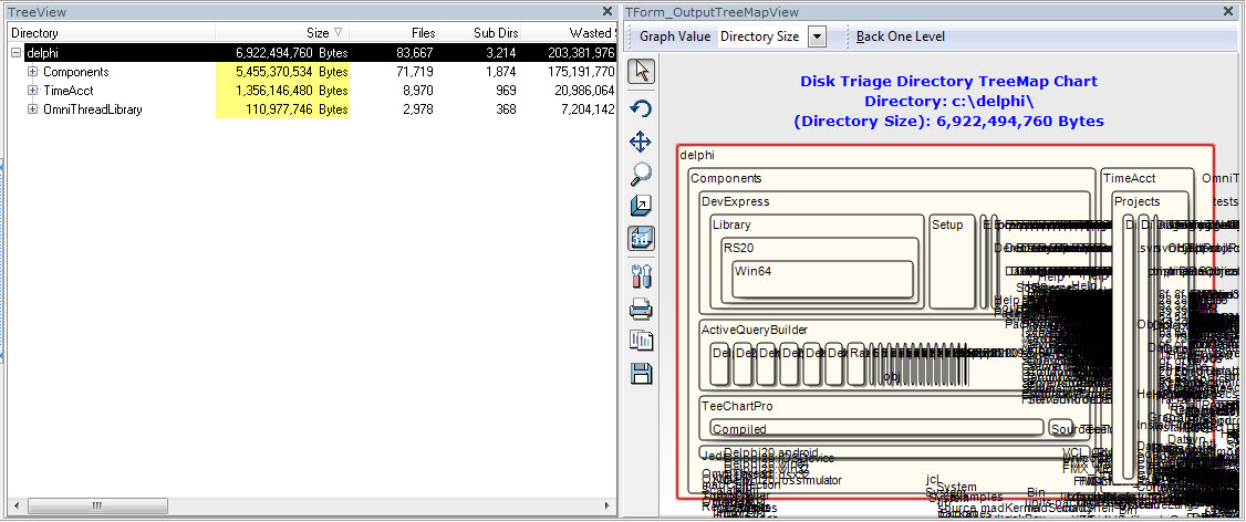

I have a program that sizes and analyzes disk space on Windows systems. In the screen shot below – you can see the Tree view on the left – and the TreeMap on the right.
Note that there are 3,214 sub-directories in the Delphi directory branch. In the past the TreeMap might take 1 or 2 seconds to draw… Now – it draws as shown below (a little messy to say the least) – and it takes over 6 seconds to render. The Program is setup to allow the TreeMap to change as the user changes selected the directory on the left…
So – from what I have seen so far – I have two issues
a) TreeMap is very slow to draw with anything over 1000 entries.
a. Ok – this may be my issue in trying to load soooo many entries. But it did not used to be such a big issue with the older version of the TreeMap.
b. Is there a way to restrict the number of entries in a TreeMap? Perhaps something like the “Other” slice capability in the regular Pie Series? Basically anything under X% got put into one pie slice?
b) Messy Looking diagram
a. Once again – this looks like it is caused by adding too many entries.
b. Is there something that can be done with settings in the TreeMap graph?
Any thoughts as to how I might deal with this? Is there anything I can provide to help analyze this issue?
TreeView/TreeMap showing Delphi directory structure with over 3000 sub-directories.
Screen capture of the Issue...

There are a couple of tickets reporting similar issues for the TreeMap series:
http://bugs.teechart.net/show_bug.cgi?id=1412
http://bugs.teechart.net/show_bug.cgi?id=1413
I've added a new ticket for the "other group":
http://bugs.teechart.net/show_bug.cgi?id=1581
However, you could always do it yourself, ie:
uses TeeTreeMapSeries;
var i, j, index, other: Integer;
    tmpValue, tmpOther1, tmpOther2: Double;
  tmpOther1:=0;
  with Chart1.AddSeries(TTreeMapSeries) as TTreeMapSeries do
    for i:=0 to 2 do
      tmpValue:=random*10;
      if tmpValue<5 then
        tmpOther1:=tmpOther1+tmpValue
        index:=Add(tmpValue, 'root ' + IntToStr(i), -1, clCream);
        tmpOther2:=0;
        for j := 0 to 5 do
          if tmpValue<5 then
            tmpOther2:=tmpOther2+tmpValue
            Add(tmpValue, 'value ' + FormatFloat('#,##0.##', tmpValue), index, clCream);
        if tmpOther2>0 then
          Add(tmpOther2, 'other: ' + FormatFloat('#,##0.##', tmpOther2), index, clCream);
    if tmpOther1>0 then
      Add(tmpOther1, 'other: ' + FormatFloat('#,##0.##', tmpOther1), -1, clCream);

I notice that on one of the bug reports (see URL below) - it states that it happens on GDI - but not GDI+. Yet I am running GDI+. While I do not see any of the lines outside the appropriate rectangle - I have in the past (earlier versions).
My issue seems to be how the labels are being drawn. Do you agree? Or am I missing something?

Post by Yeray » Tue Jul 19, 2016 7:38 am
I wasn't sure if you were using GDI or GDIPlus. If you are using GDIPlus, the default, the ticket #1413 shouldn't affect you.
