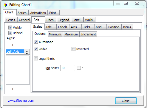

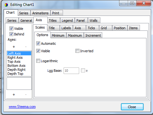

I am testing the new version of TChart Pro and made a small application with TChartEditor (in Delphi XE5). I recognized that the standard height of the axes list under "Axis" is very small so that only one axis is visible. That's a strange layout setting! Is it possible to set the height programmatically before showing the editor?
I changed the height manually but after opening the editor again I see the default behaviour. The list for manually added axes should be smaller and the list for existing axes bigger.

- wished layout
- ChartEditor wish.PNG (43.37 KiB) Viewed 9082 times
- default layout
- ChartEditor v2016.PNG (32.93 KiB) Viewed 9073 times
