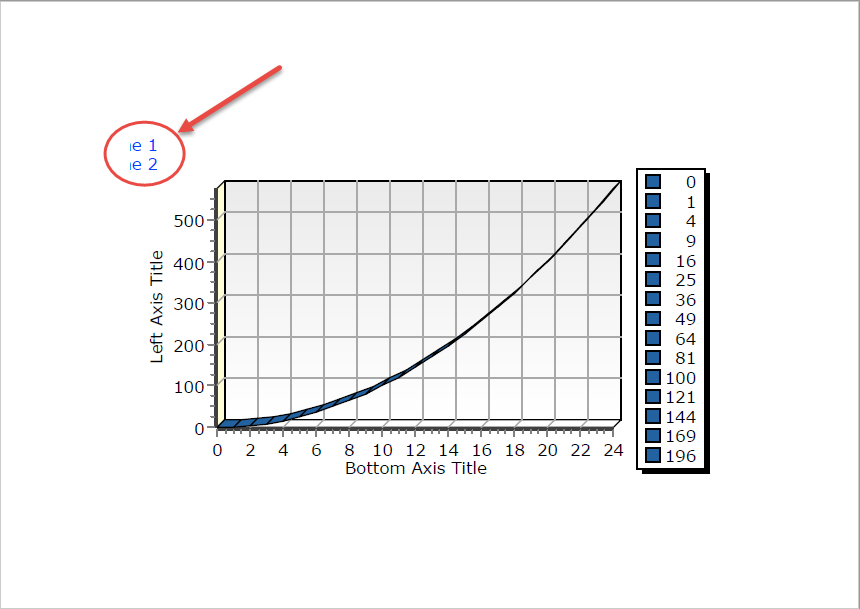

when the chart title position is left justified or right justified then the position on print is wrong. If the position is left justified then the chart title text is not readable (truncated).
For example: Use the following code
  Chart1->Title->Alignment = taLeftJustify;
  Chart1->Title->TextAlignment = taLeftJustify;
  Chart1->Title->Text->Clear();
  Chart1->Title->Text->Add(L"Chart Title Line 1");
  Chart1->Title->Text->Add(L"Chart Title Line 2");
to have two chart title lines which are left justified. Then use the ChartPreviewer component to print the chart => only small parts of the chart title is printed.
Screenshot of the chart printed to a PDF
The attached project is for C++Builder 10.1 Berlin using TeeChart Pro 2016.18.

Re: Wrong chart title position on print
Post by Sandra » Tue Aug 09, 2016 10:50 am
Hello Hans,
The problem is caused so the Text aren't drawn in the print area, therefore I would like suggest you modify the print area margins, so the titles can be drawn without problems.
To do this, you should add the lines below in the Print button:
void __fastcall TForm1::Button1Click(TObject *Sender)
	Chart1->PrintProportional =false;
	Chart1->PrintMargins =Rect(2, 5, 2, 5);
	ChartPreviewer1->Execute();
Also, I have attached the project you sent me, with the modified code.
TChart-Test2Mod.zip
(56.51 KiB) Downloaded 835 times

thank you for the quick reply. Your solution works also for the real application. However, I would see the solution as workaround because in the print preview the title is always displayed within the margins. And the chart title left position is in line with the left axis title. So there is no reason for the chart title text to be truncated in the print output.

Seems the problem is caused for the print Orientation. We're investigating where is the problem. Meanwhile, I would suggest you modify the print area margins or enable the Smoothed options before print.
