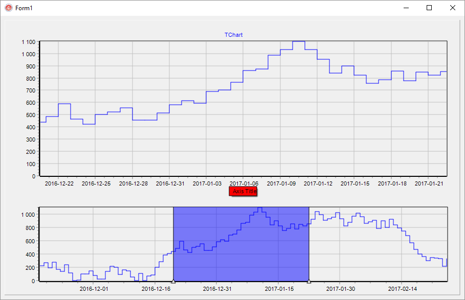

When chart is unzoomed it looks like this
There is a lot of free space below axis titile

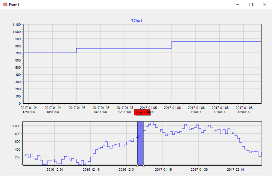

When one try to zoom and labels are really multiline labels are cover axis title.

Re: Axis label height calculation does not consider multiline
Post by Yeray » Fri Nov 18, 2016 11:15 am
Hello Grzegorz,
I could reproduce the problem you are reporting so I've re-factored the fix for #1684.
Since you own the Source Code I'll send a mail with the modified TeEngine.pas unit to the mail you have registered in this forum.
