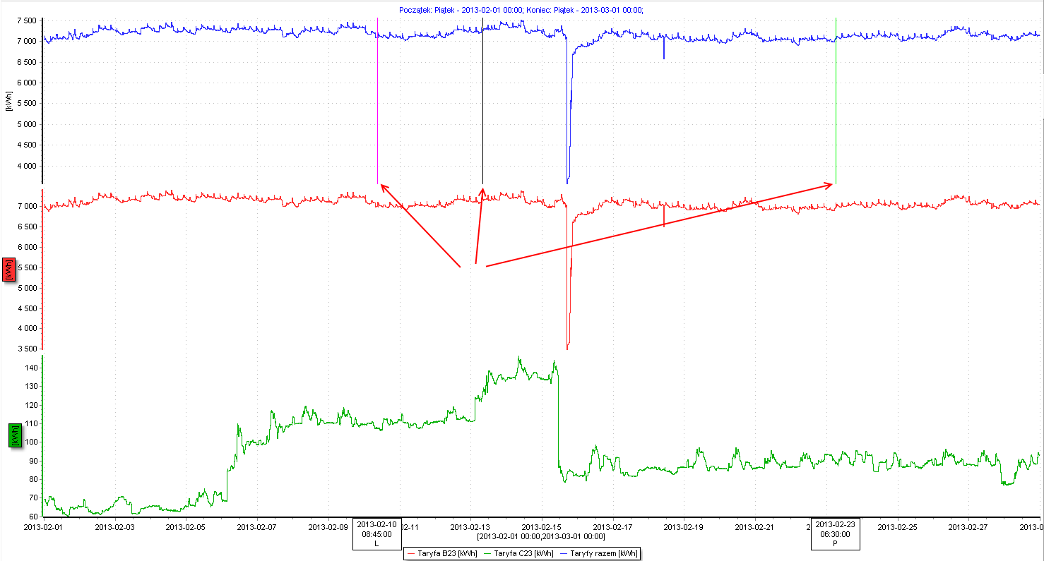

TCursorTool wrong length when it's not attached to series
Technicon
Posts: 43
Joined: Thu Aug 11, 2016 12:00 am
Post by Technicon » Thu Nov 24, 2016 7:26 am
When TCursorTool is not attached to series it should be draw from top to the bottom of a chart (left right if it's horizontal).
Grzegorz
Re: TCursorTool wrong length when it's not attached to series
Post by Yeray » Thu Nov 24, 2016 9:06 am
Hello Grzegorz,
I could reproduce the issue so I've added it to the public tracker:
http://bugs.teechart.net/show_bug.cgi?id=1694
Thanks for reporting it.
