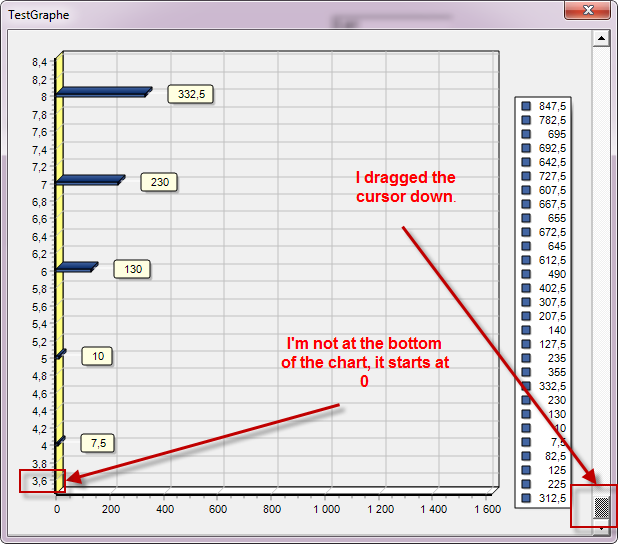

Hello again.
I repeat my previous example with 100 values (http://www.teechart.net/support/viewtop ... =3&t=16346).
I arrive in this situation :
Then click on the down arrow to continue down to the bottom.
Re: The TScrollBar do not go to the ends
Post by Yeray » Wed Nov 30, 2016 10:02 am
That sounds as a bug on the TChartScrollBar. We use to recommend to use the standard TScrollBar instead of TChartScrollBar because it presents some problems.
I'm sorry for the inconvenience.
