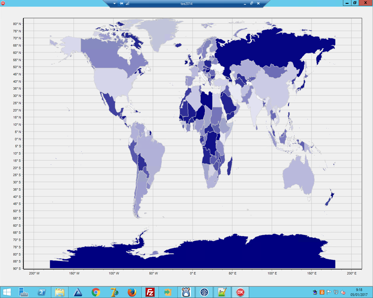

I'm moving the .exe to the remote machine, accessing it with remote desktop, running the .exe, [optionally, closing the remote desktop], reaccessing it with remote desktop. And I can see the application running without problems.

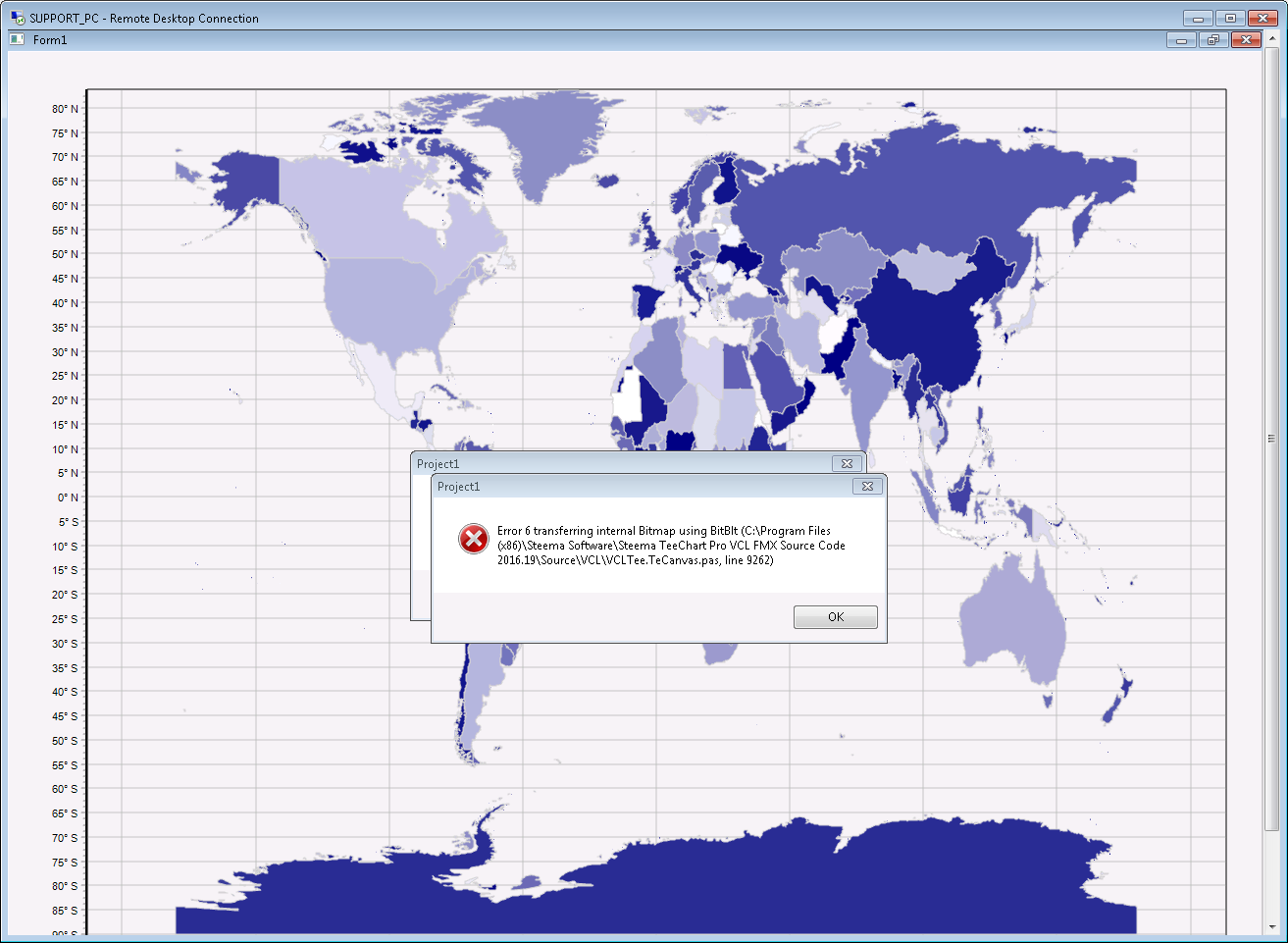

Error 6 from Windows 7 machine.png (133.62 KiB) Viewed 11114 times
I downloaded your attached code, added the Win64 platform, the search path to the source code and an output directory.
I can reproduce the error, but only on Windows 7 machines. It seems to work if I run the same exe on a Windows 10 machine.

Post by Yeray » Thu Jan 05, 2017 1:18 pm
Hello Johanna,
I reproduced the error now, with a Windows 7 x64 virtual machine.
You don't even need to use remote desktop to reproduce the problem. Just logout through "Switch user" option and login back.
I'm also reproducing the problem without having the window maximized and targeting Win32 platform.

The error code 6 seems to indicate the Handler was invalid in the last call:
https://msdn.microsoft.com/en-us/librar ... 85%29.aspx
And the last call was:
    BitBlt( ACanvas.Handle,ALeft,ATop,
            FBitmap.Width,
            FBitmap.Height,
            FBitmap.Canvas.Handle,0,0,SRCCOPY);
So I guess the action of switching the windows session may be reassigning the handlers and this causes this assertion failure.
