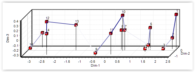

Oh, I just discovered that the 3D vector series I needed actually does exist. The TVector3DSeries series is in the VCLTee.TeeSurfa unit. Now the problem is that some lines display too light (see the screenshot). Perhaps they are drawn but much too light.
Screen Shot 03-23-17 at 08.20 AM.PNG (24.79 KiB) Viewed 15659 times

JimR wrote:Now the problem is that some lines display too light (see the screenshot). Perhaps they are drawn but much too light.
You only have to disable UseColorRange as shown above :)

Post by JimR » Sun Mar 26, 2017 7:41 am
OK, this solves that problem - thanks.
