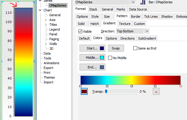

Regardless of the rendering mode the Gradient seems not to respect the Gradients 'EndColor':
As you can see the Top color (see red arrow) and the color on the 'End...' button seems to be some sort of blue but I had set it to dark red in the gradient construction window (see image).

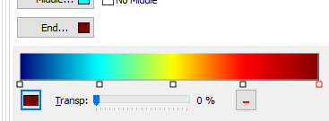

If I set that color again the button shows it for a moment:
but as soon as you move the mouse over that button the color gets blueish again (the BarSeries never changes).
Same behaviour if you use one of the 'Default' colormaps and with any EndColor in GDI-Mode too.

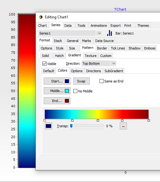

With a couple of modifications, this seems to work fine:
