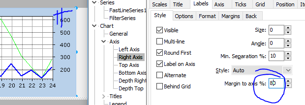

Margin to axis % not stored in .dfm
Post by Whookie » Mon Apr 03, 2017 4:09 pm
The margin to axis % isn't stored in the .dfm (at least of the 'Right Axis'):
After reopening the form (or compiling and running an application) that value is reset to 10%
Re: Margin to axis % not stored in .dfm
Post by Yeray » Thu Apr 06, 2017 8:34 am
I could reproduce it so I've added it to the public tracker:
http://bugs.teechart.net/show_bug.cgi?id=1833
Thanks for reporting it.
