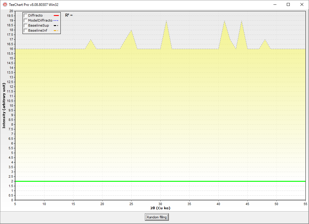

With v8.08 I get a band still drawn, even if all the series are disabled:
I could reproduce and identify the problem here:
http://bugs.teechart.net/show_bug.cgi?id=1836
I've also fixed it for the next maintenance release.
