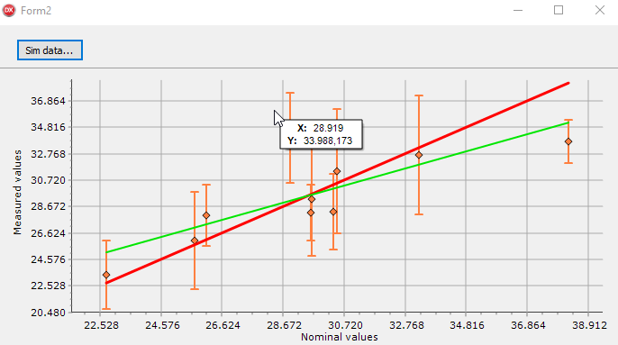

Using a MarkTipTool with a TErrorSeries triggers the hints some distance left of the bar (you can use the sample attached to the previouse post).

I've been able to reproduce the problem so I've added it to the public tracker:
http://bugs.teechart.net/show_bug.cgi?id=1839
Thanks for reporting it.
