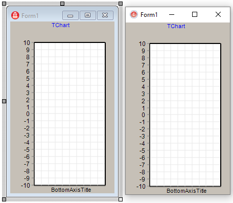

I made a simple sample project that shows that Ariel 9 fonts are NOT correctly printed as LeftAxis number labels. The Arial 9 fonts appear correctly in the uncompiled Form1 of Unit1.cpp (LEFT side of Anderson_TChartBUG_Arial_vs_SansSerif.png
in the attached Anderson_TChartBUG_Arial_vs_SansSerif.zip file). However, when the program is compiled and run, the numbers appear to be MS Sans Serif in the project1.exe executable (RIGHT side of Anderson_TChartBUG_Arial_vs_SansSerif.png in the attached *.zip file). These 'Sans Serif'-like fonts are block-like and do not show the complex shading of the darker Arial 9 fonts seen in Unit1.cpp.
In Anderson_TChartBUG_Arial_vs_SansSerif.zip I have included the code showing the BUG. One difference, however, is that although I own the licensed to TChart Pro v2016.18, for this project I actually didn't need to use the TChart Pro,
and the TChart code in the project I sent is just the Standard TChart code included in RAD Studio XE 10.1 Berlin, Update 1. Presumably this wont be the cause of the bug.
I have tried for TWO DAYS to upload my attachment file, but your server is NOT WORKING. Therefore, you can download my zip file from my university server:

Re: Cannot change font name for numbers on TChart axes
I added "915" to all "tee" references in the cbproj, opened the project with RAD XE and this is what I get with it:
It seems as if your application was using GDI instead of GDIPlus.
If I open the dfm as text and I change this:
for this:
Then I get the same result you are getting.
DefaultCanvas = 'TGDIPlusCanvas'
DefaultCanvas = 'TCanvas3D'

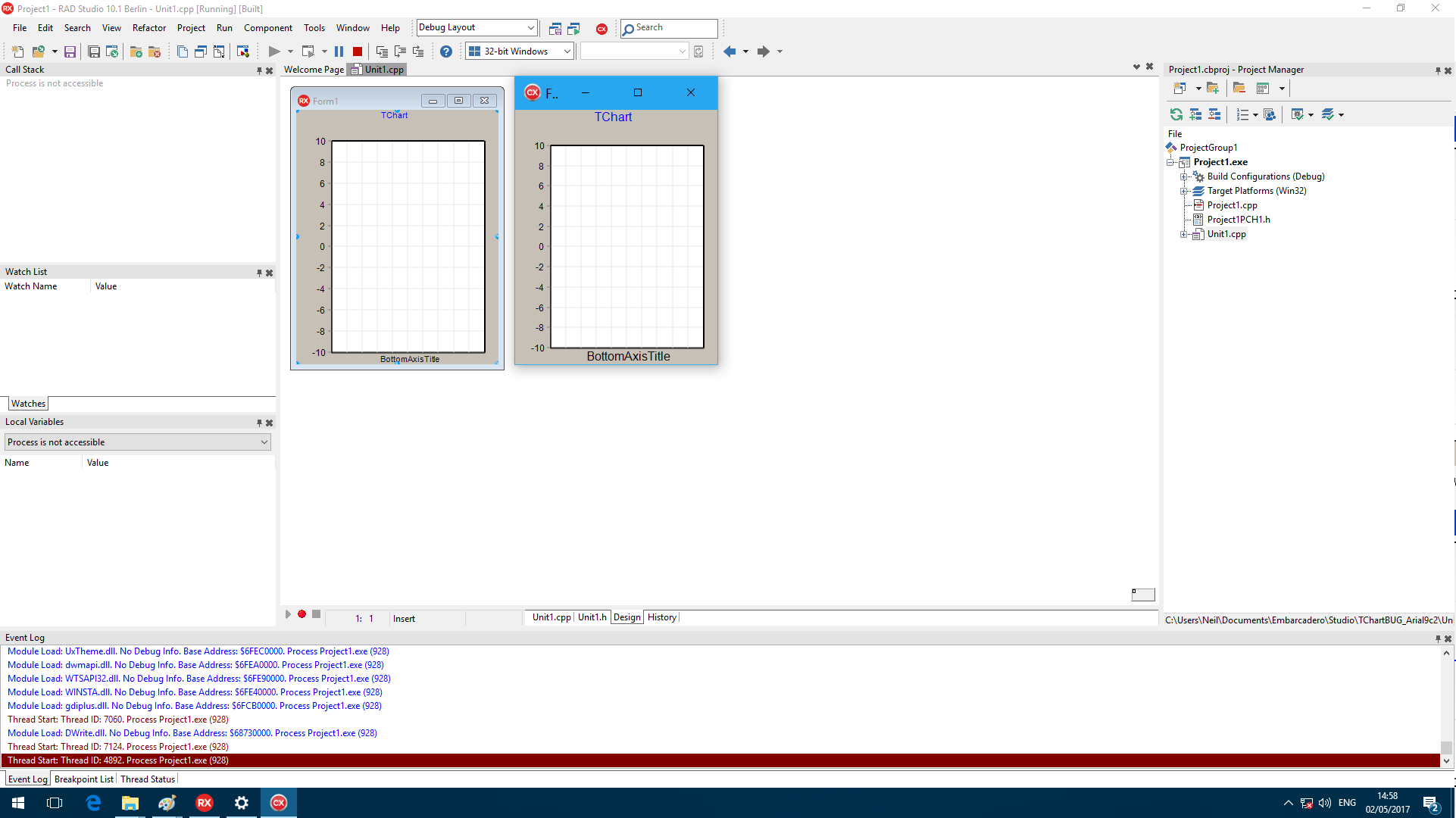

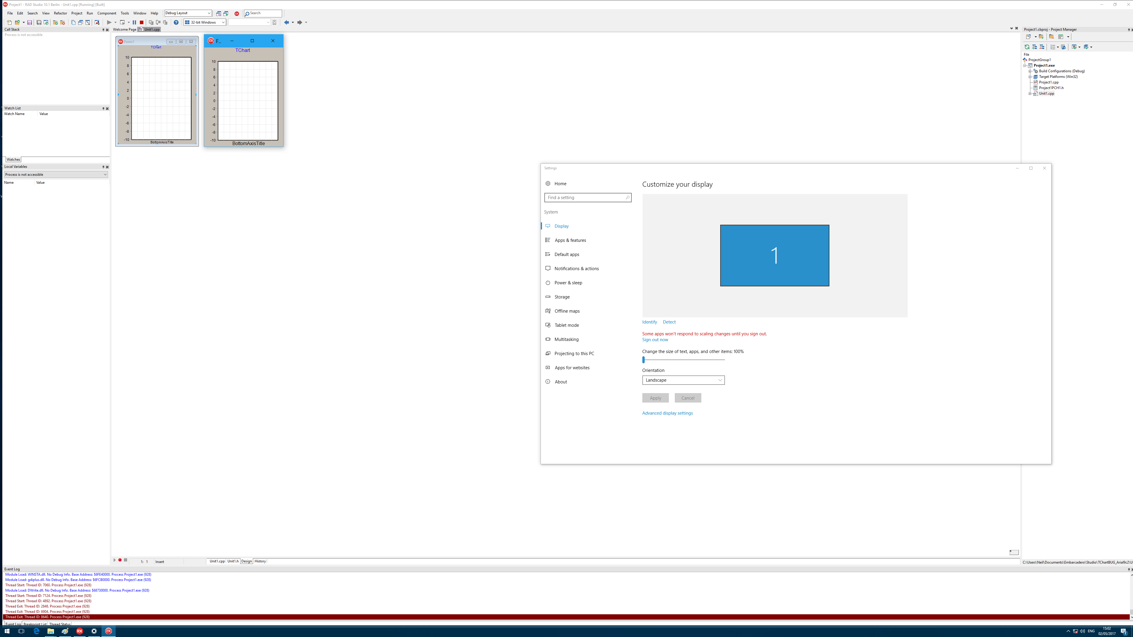

Thenk you. I got the code TO WORK at 100% of the native resolution of my monitors: 1920 x 1080 and 3840 x 2160.
(See TChartBUG_1920x1080_100%.png and TChartBUG_3840x2160_100%.png.)

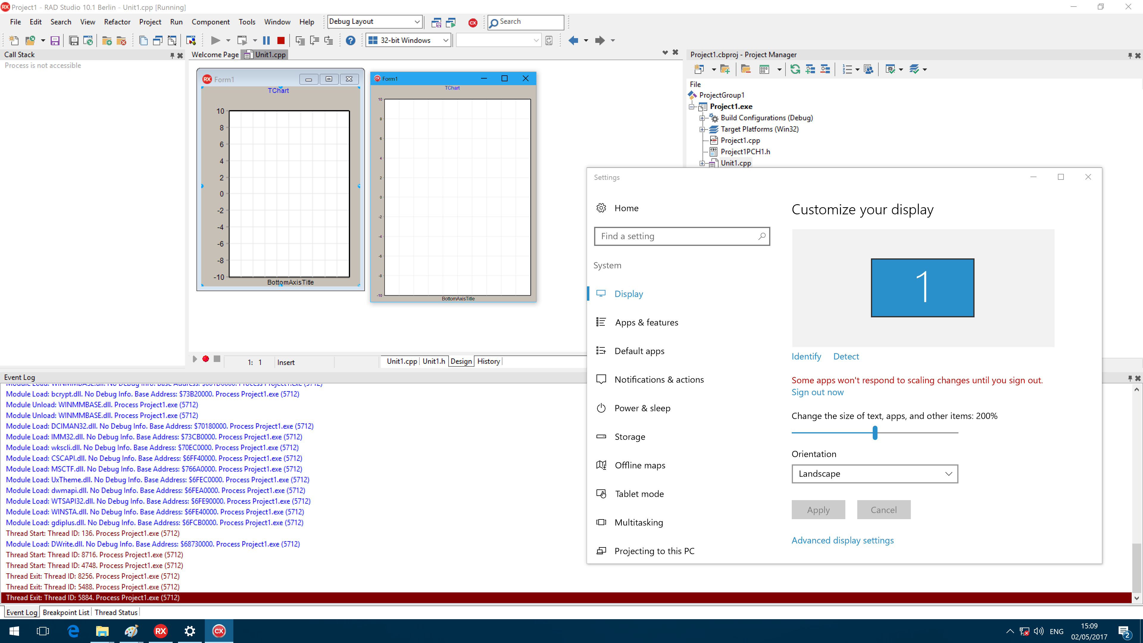

However I did find an additional bug that if you set one of the high resolution monitors to its native resolution (3840 x 2160) and then changed the
size of the text to 200% (by RightMouseButtonClick on WholeScreen -> Settings -> Display -> Change the size of text, apps, and other items: 200%)
which EFFECTIVELY would create a 1920 x 1080 monitor, the project1.exe TChart font sizes were INCORRECTLY HALF those in the RAD Studio XE10.1.
(See TChartBUG_3840x2160_200%.png.) This is a BUG. In contrast, the fonts in TLabels and TPanels appear correct at 3840 x 2160 at 200%.
I just wanted to bring your attention to this which you would not find if you were always using the native resolution of your monitor.
However, higher resolution monitors like 3840x2160 are now available quite cheap (<£300) and so more and more customers will
be using very high resolution monitors at size of text settings > 100%.

Hi Versay,
No, this does not work correctly, ie when the high resolution monitor was set to its native resolution (3840 x 2160) and the size of the text was set to 200%,
the project1.exe TChart font sizes were still INCORRECTLY HALF those in the RAD Studio XE10.1.
But now, instead the size of the number font increases when the size of the TChart increases (when manually elongated or increased in height). I definitely don't want this, so
TChart1->View3DOptions->ZoomText=ztAuto; definitely does not seem the way to go.
Also, the Arial number fonts on the left axis do not respond to whether the Windows 10 ClearType check box is checked or unchecked. In other words,
the TChart number fonts just don't respond the way the fonts do in C++Builder's TPanel or TLabel.
I don't know if anything can be done about this. I may have to stick with the old MS Sans Serif which do work correctly when the high resolution monitor
is set to its native resolution (3840 x 2160) and the size of the text is set to 200% - the font sizes were CORRECTLY equal to those in the RAD Studio XE10.1.

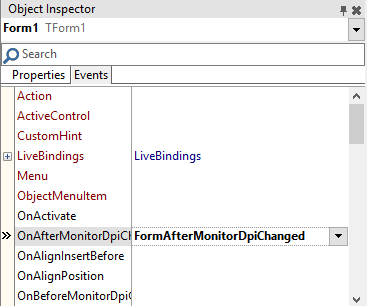

Hello Bill,
The trick consists on creating a helper class to allow accessing a protected method.
Here is how you can do it in CBuilder:
Note you have to create the FormAfterMonitorDpiChanged method using the Object Inspector:
class TCustomTeePanelAccess : public TCustomTeePanel
public:
DYNAMIC void __fastcall ChangeScale(int M, int D)
TCustomTeePanel::ChangeScale(M,D);
void __fastcall TForm1::FormAfterMonitorDpiChanged(TObject *Sender, int OldDPI, int NewDPI)
((TCustomTeePanelAccess*)TChart1)->ChangeScale(NewDPI, OldDPI);
