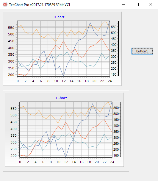

Re: Saving Data to .tee file
Post by Yeray » Fri Apr 21, 2017 10:28 am
It seems to work fine for me with v2017.21 here.
testCBuilderImport.zip
(85.97 KiB) Downloaded 1174 times
