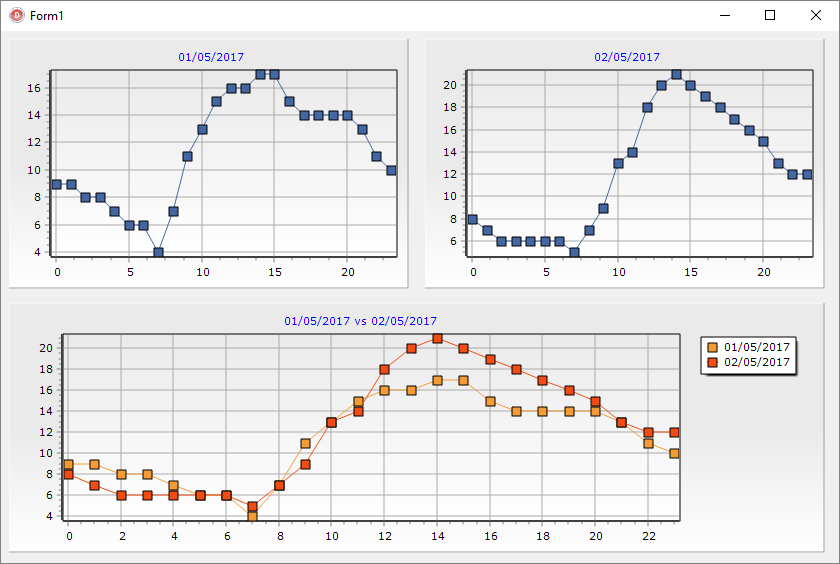

Knowing what you have and what you want to get from the charts stored in your tee files, you can:
- Load the first tee file into the final chart
- Load the second tee file into a dummy temporal chart
- Clone series or tools from the dummy chart to the final chart.
Ie, here I use 3 charts. The first two are to generate the tee files, the third is the destination chart I use to load the two tee files into:
uses Series, TeeStore;
var i: Integer;
    tmpChart: TChart;
    oldX, oldY, oldW, oldH: Integer;
const temp1: array[0..23] of Integer = (9, 9, 8, 8, 7, 6, 6, 4, 7, 11, 13, 15, 16, 16, 17, 17, 15, 14, 14, 14, 14, 13, 11, 10);
      temp2: array[0..23] of Integer = (8, 7, 6, 6, 6, 6, 6, 5, 7, 9, 13, 14, 18, 20, 21, 20, 19, 18, 17, 16, 15, 13, 12, 12);
      fileName1='E:\tmp\Temp_01052017.tee';
      fileName2='E:\tmp\Temp_02052017.tee';
  Chart1.Legend.Visible:=False;
  Chart1.View3D:=false;
  with Chart1.AddSeries(TLineSeries) as TLineSeries do
    Pointer.Visible:=True;
    for i:=0 to High(temp1) do
        AddXY(i, temp1[i]);
  Chart1.Title.Text.Text:='01/05/2017';
  Chart2.Legend.Visible:=False;
  Chart2.View3D:=false;
  with Chart2.AddSeries(TLineSeries) as TLineSeries do
    for i:=0 to High(temp2) do
        AddXY(i, temp2[i]);
  Chart2.Title.Text.Text:='02/05/2017';
  SaveChartToFile(Chart1, fileName1);
  SaveChartToFile(Chart2, fileName2);
  //Load Charts
  RegisterTeeStandardSeries;
  oldX:=Chart3.Left;
  oldY:=Chart3.Top;
  oldW:=Chart3.Width;
  oldH:=Chart3.Height;
  LoadChartFromFile(Chart3, fileName1);
  Chart3.Left:=oldX;
  Chart3.Top:=oldY;
  Chart3.Width:=oldW;
  Chart3.Height:=oldH;
  tmpChart:=TChart.Create(Self);
  LoadChartFromFile(tmpChart, fileName2);
  CloneChartSeries(tmpChart[0], Chart3);
  Chart3[0].Title:=Chart3.Title.Text.Text;
  Chart3[1].Title:=tmpChart.Title.Text.Text;
  Chart3.Legend.Visible:=True;
  Chart3.Title.Text[0]:=Chart3.Title.Text[0] + ' vs ' + tmpChart.Title.Text[0];
  Chart3[0].Color:=OperaPalette[1];
  Chart3[1].Color:=OperaPalette[2];
  FreeAndNil(tmpChart);

Re: Multiple .tee plots on one Chart
Post by Yeray » Fri May 12, 2017 2:22 pm
Indeed, it's a bit different in CBuilder:
  double temp1[24] = {9, 9, 8, 8, 7, 6, 6, 4, 7, 11, 13, 15, 16, 16, 17, 17, 15, 14, 14, 14, 14, 13, 11, 10};
  double temp2[24] = {8, 7, 6, 6, 6, 6, 6, 5, 7, 9, 13, 14, 18, 20, 21, 20, 19, 18, 17, 16, 15, 13, 12, 12};
  AnsiString fileName1 = "E:\\tmp\\Temp_01052017.tee";
  AnsiString fileName2 = "E:\\tmp\\Temp_02052017.tee";
  Chart1->Legend->Visible=False;
  Chart1->View3D=false;
  Chart1->AddSeries(new TLineSeries(this));
  dynamic_cast <TLineSeries*>(Chart1->SeriesList->Items[0])->Pointer->Visible=True;
  for (int i=0; i<24; i++)
	Chart1->SeriesList->Items[0]->AddXY(i, temp1[i]);
  Chart1->Title->Text->Text="01/05/2017";
  Chart2->Legend->Visible=False;
  Chart2->View3D=false;
  Chart2->AddSeries(new TLineSeries(this));
  dynamic_cast <TLineSeries*>(Chart2->SeriesList->Items[0])->Pointer->Visible=True;
	Chart2->SeriesList->Items[0]->AddXY(i, temp2[i]);
  Chart2->Title->Text->Text="02/05/2017";
  //Load Charts
  RegisterTeeStandardSeries();
  int oldX=Chart3->Left;
  int oldY=Chart3->Top;
  int oldW=Chart3->Width;
  int oldH=Chart3->Height;
  Chart3->Left=oldX;
  Chart3->Top=oldY;
  Chart3->Width=oldW;
  Chart3->Height=oldH;
  TChart *tmpChart = new TChart(this);
  Chart3->AddSeries(CloneChartSeries(tmpChart->SeriesList->Items[0]));
  Chart3->SeriesList->Items[0]->Title=Chart3->Title->Text->Text;
  Chart3->SeriesList->Items[1]->Title=tmpChart->Title->Text->Text;
  Chart3->Legend->Visible=True;
  Chart3->Title->Text->Text=Chart3->Title->Text->operator [](0) + " vs " + tmpChart->Title->Text->operator [](0);
  Chart3->SeriesList->Items[0]->Color=OperaPalette[1];
  Chart3->SeriesList->Items[1]->Color=OperaPalette[2];
