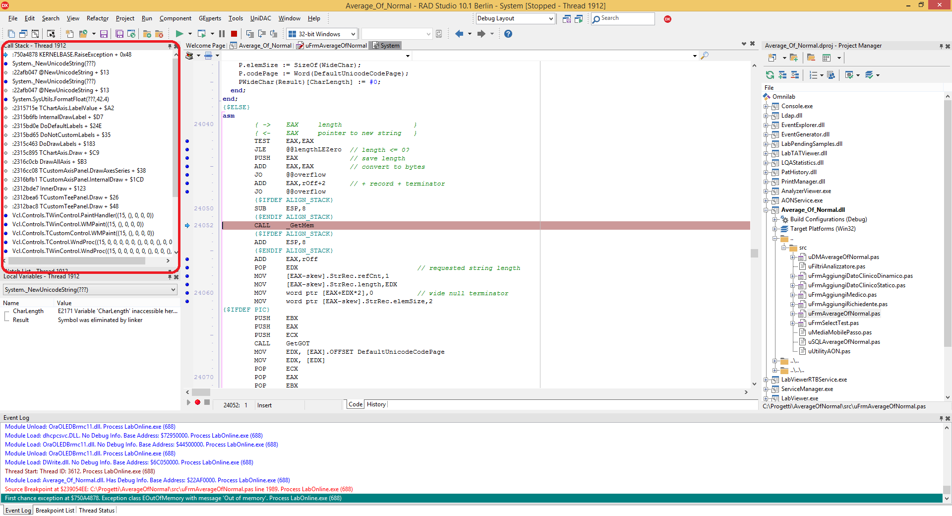

I've made a porting of one of my dll modules that uses TeeChart. The version is 2016.19.
I've the same module running without problem in XE2 environment with TeeChart 2012.
When I run my module in debug point it give me an Out Of Memory error with the Stack Trace in the attached picture.
What can be?
What can be?
