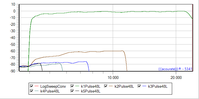

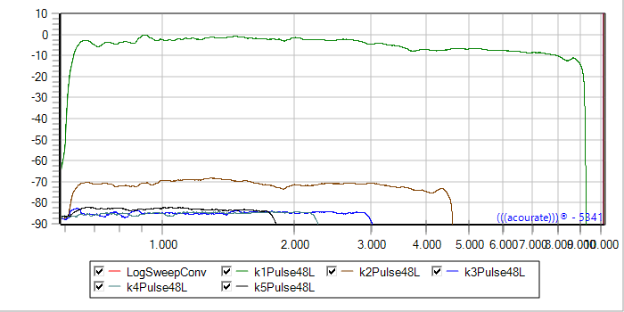

The devil is given by Chart.BottomAxis.Increment. By default the value is 0 and we get x axis labels at positions 1, 10, 100, 1000 ...
If the value is changed to 1 then we get x axis labes at 1000, 2000, 3000 ... But if the chart is zoomed the labels can overlap.
Dragging a window corner to resize the window even shows up the x axis labels jumping between different visualizations.

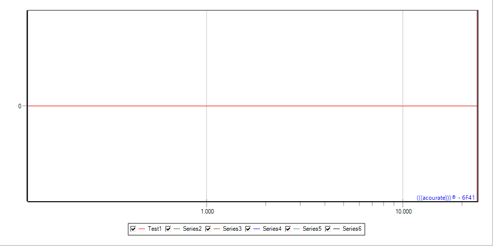

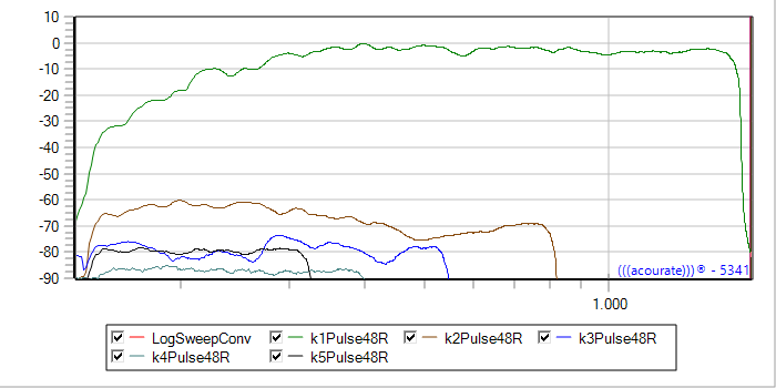

And finally there is still a bug with zoom:
So if you e.g. create a chart with logarithmic x axis from 1 to 10000 and you zoom into the chart from 150 to 10000 the minor ticks below 1000 get lost.
See the picture, where 8 minor ticks are missed. So there is no chance to estimate the x axis position according to a given curve point:

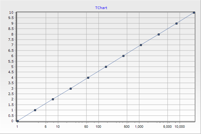

Sounds as the request in #890 but you you could try using custom labels as follows:
uses Series, Math;
var i: Integer;
  Chart1.Align:=alClient;
  Chart1.View3D:=False;
  Chart1.Legend.Hide;
  with Chart1.AddSeries(TLineSeries) as TLineSeries do
    Pointer.Show;
    Pointer.Size:=2;
    for i:=0 to 10 do
       AddXY(exp(i), i);
  Chart1.Axes.Bottom.Logarithmic:=True;
  Chart1.Axes.Bottom.Increment:=1;
  Chart1.Axes.Bottom.Items.Clear;
  for i:=0 to 5 do
    Chart1.Axes.Bottom.Items.Add(power(10, i), FormatFloat('#,##0.##', power(10, i)));
    Chart1.Axes.Bottom.Items.Add(power(10, i)*5, FormatFloat('#,##0.##', power(10, i)*5));
