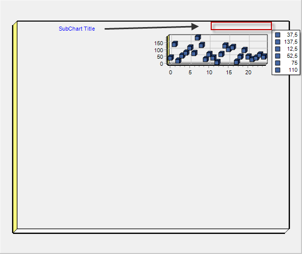

I want to center the title of my subgraph with AdjustFrame = false.
I use this code:
TChart * Chart1 = new TChart(this);
	Chart1->Parent = this;
	Chart1->Align = alClient;
	TSubChartTool *SubChart1 = new TSubChartTool(NULL);
	Chart1->Tools->Add(SubChart1);
	TChart * Chart2 = SubChart1->Charts->AddChart("MySubChart");
	Chart2->AddSeries(new TPointSeries(Chart1))->FillSampleValues();
	Chart2->Legend->Visible = true;
	Chart2->Title->Caption = "SubChart Title";
	Chart2->Title->Visible = true;
	Chart2->Title->AdjustFrame = false;
	SubChart1->Charts->Items[0]->Left = SubChart1->ParentChart->Width / 2;
	SubChart1->Charts->Items[0]->Width = SubChart1->ParentChart->Width / 2;

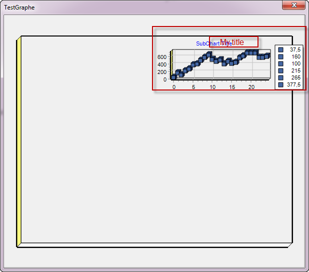

In this situation, the title is not centered above my graph, as you can see in the attachment file.
While waiting for the bug fix, is there a solution ?
SubChart Title.png (10.35 KiB) Viewed 9952 times

I just want my title to be centered on the graph + legend.
When the line is deleted, the title is centered above the graph, without taking into account the place taken by the plenum.
There may be another property to do that?
I attached the file "Test 2" with the expected centering in red for the title
Test 2.png (20.62 KiB) Viewed 9936 times
