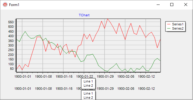

Hello
Incorrect axis area size (height) when title using html (Build 2017.22.170619)
Here Is a simple example

View before zoom

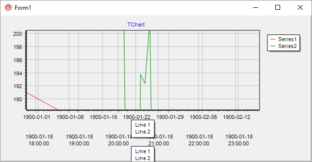

View after zoom

Post by Yeray » Tue Jul 11, 2017 12:49 pm
Hello Grzegorz,
I've reproduced the problem so I've added it to the public tracker:
http://bugs.teechart.net/show_bug.cgi?id=1889
Thanks for reporting it.
