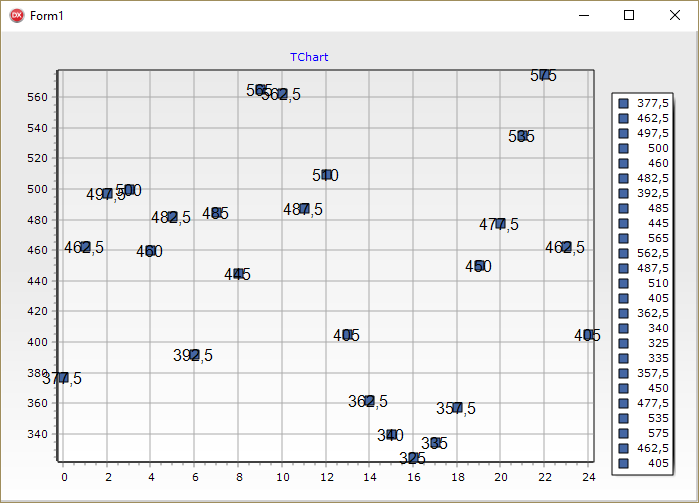

Using the mark strings to identify points in a TPointSeries works but I would like to make a small adjustment in their positions of the labels. The labels are a little too high - especially if I use a larger font. I would prefer the text to be centered vertically on each symbol.

Hello Jim,
If you have the Series Marks set to transparent, you could always use instead custom text drawing e.g.
procedure TForm1.AfterDraw(Sender: TObject);
var t, w, h:Integer;
    str: String;
   Chart1.Canvas.Font.Size:=12;
   for t := 0 to Series1.Count do
      str:=FloatToStr(Series1.YValues[t]);
      w:=Chart1.Canvas.TextWidth(str) div 2;
      h:=(Chart1.Canvas.TextHeight(str) div 2) - (Series1.Pointer.VertSize div 2);
      Chart1.Canvas.TextOut(Series1.CalcXPos(t) - w, Series1.CalcYPos(t) - h, str);
  Chart1.View3D := False;
  Series1.FillSampleValues();
  {Series1.Marks.Visible:=true;
  Series1.Marks.Transparent:=true;
  Series1.Marks.Font.Size:=16;}
  Chart1.OnAfterDraw:=AfterDraw;
which gives you this:

Re: Adjust positions of marks in a TPointSeries?
Post by Yeray » Tue Jul 18, 2017 10:41 am
If it fits your needs, a simpler alternative could be to just set a negative ArrowLength. Ie:
  Chart1.View3D:=False;
  Chart1.Legend.Visible:=False;
  Series1.FillSampleValues(10);
  Series1.Marks.Transparent:=True;
  Series1.Marks.ArrowLength:=-Series1.Marks.Font.Size;
  Series1.Marks.Arrow.Visible:=False;
