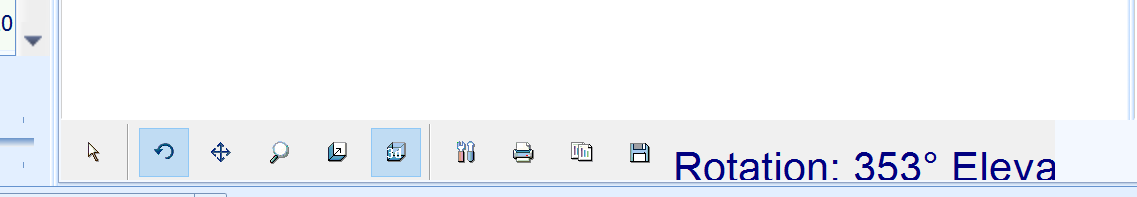

when using the TTeeCommander on a HighDPI device , like a Microsoft Surface (Pro 4) the label showing the rotation degree, zoom factor etc
is displaced and much too big.
Is there a way to influence the font size and the placement somehow ?

Post by Yeray » Tue Jul 18, 2017 11:56 am
Note the TeeChart Editor and the TeeChart Commander have been designed to help the developer to build and test their applications. These tools aren't designed to be accessed by the final users, so we don't recommend giving access to it.
This having said, you can try modifying the EditText TLabel. Ie:
  TeeCommander1.LabelText.Top:=TeeCommander1.LabelText.Top-10;
