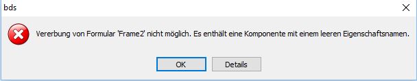

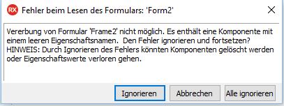

There is a reproducable error when placing a frame on a form if the frame contains a TChart with a ScrollPager tool.
Attached are two error messages along with a demo project.

Delphi is complaining about a component with an empty propertyname.

I see the TSubChartTool is created without a name in the .dfm. You can open the frameUnit2.dfm as text and modify the line:
    object TSubChartTool
To have this:
    object SubChartTool1: TSubChartTool
With this modification everything works without errors. Could you please confirm it?
