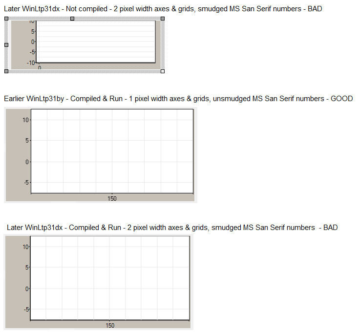

I think I have a bug in TChart. I am trying to have axes and grids of 1 pixel width, but they are all 2 pixels wide. I am also trying to use axes numbers with the MS Sans Serif (which is not 'smudged' like Arial), but I appear to have the smudged Arial number fonts. I am using RAD Studio XE 10.1 Berlin and VCL Chart Pro 2016.
In the Object Inspector I have put in things like
TChart1->LeftAxis->Axis->Width = 1
TChart1->LeftAxis->Grid->Width = 1
TChart1->LeftAxis->LabelsFont->Name = MS Sans Serif
but to no avail.
As shown in the attached TChart_2PixelAxesGrid_SmearedNumbers.png file, in the top panel, the non-compiled TChart in the RAD Studio development system INCORRECTLY show 2 pixel wide axes & grids, and smudged numbers that are NOT MS Sans Serif.
The middle panel shows an EARLIER compiled and run program showing the CORRECT 1 pixel wide axes & grids, and UNsmudged numbers that ARE MS Sans Serif. Note that the non-compiled TChart of this INCORRECTLY showed 2 pixel wide axes & grids, and smudged numbers that are NOT MS Sans Serif (not shown).
The bottom panel shows the LATER (current) compiled & run TChart NOW INCORRECTLY show 2 pixel wide axes & grids, and smudged numbers that are NOT MS Sans Serif.
First of all, shouldn't non-compiled TChart immediately show the axes and grid widths and LabelsFont name entered into the Object Inspector.
And second, what would cause the EARLIER program to compile & run correctly (1 pixel widths and MS Sans Serif) but not the LATER program (2 pixel widths and Arial? fonts)? Do you know of any 'magic' Object Inspector variable that can fix these problems including have the non-compiled TChart show what's in the Object Inspector.

- TChartBUG_2PixelAxesGrid_SmearedNumbers.png (17.45 KiB) Viewed 29954 times

Thanks! Changing from GDI+ back to GDI was that magic change that pretty much fixed everything. The axes and grids are now correctly 1 pixel in width, and the font is the correct MS Sans Serif.

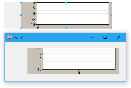

I have also included a pictorial result of this program (TChartBug__NumPixels_BottomAxis_to_Numbers__GDI_LabelSep1.png - I added the red dots in Paint.exe).
Perhaps using this program to solve the problem would allow me to quickly fix this bug in my main program.

- TChartBug__NumPixels_BottomAxis_to_Numbers__GDI_LabelSep1.png (7.11 KiB) Viewed 29889 times

All the problems in this thread have been solved.
The cause of the last bug turned out to be a TChart hidden on a normally unused hidden tabsheet. Removing this TChart and removing all the references to <VclTee.TeeGDIPlus.hpp> fixed the problem.
Many Thanks.
