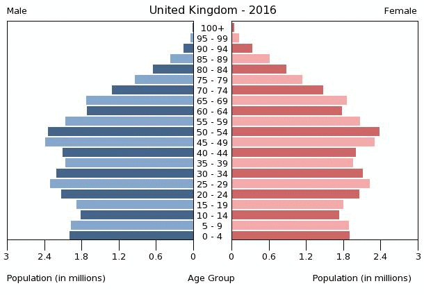

Is it possible to plot an Age Pyramid with TeeChart? (like the attachement)
I am working with Builder C++ and Teechart Pro v2015.14
After some research I found this http://www.steema.com/support/Tutorials ... l_0006.htm but it's not working

Have you tried with the TDoubleHozBarSeries (in TeeDoubleHorizBar unit)?
