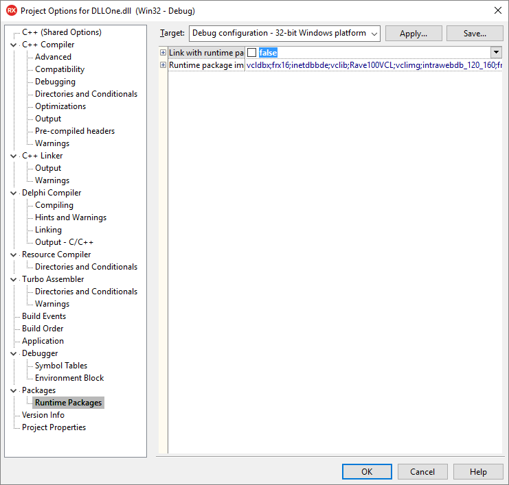

I believe this is similar to this old topic.
Try unchecking "link with runtime packages" in all the dlls.

Re: Runtime Exception with 2017.22 and C++
I meant the "link with runtime packages" option here:RG Solutions wrote:In the test case that I sent, it has both the DEBUG and RELEASE builds. The DEBUG build uses "static" linking for the DLLs, and the RELEASE build uses "dynamic" linking for both DLLs. The problem still occurs whether you use "static" or "dynamic" linking.

I figured out what my problem was. I will explain what happened so that someone else that might have this same issue will know how to fix it. However, I must make one comment.
Regarding your suggestion about make "Link with runtime packages" false. This is great if you have a single DLL or no DLLs at all. However, if you are using multiple DLLs it is almost always necessary to "Link with runtime packages" for two reasons. The first is the size of the files. When you have 34 different object files as part of the install, this takes up a huge amount of extra disk space. The second issue is that with multiple DLLs, if they are not "Linked with runtime packages", then you most surely will have VCL conflicts and the program will not run. The only way I have been able to make my processing run is linking with runtime packages.
Now on to the original issue. The issue with the test case I sent was very subtle. When someone sets "Link with runtime packages" to true, one would assume that all packages used by the processing would be "runtime linked". The truth is that when this option is set to true, it will only link the packages that are included in the accompanying list. This means that in the test case I included, all the VCL packages would be runtime linked, and the TeeChart packages would be statically linked because they were not in the list. Mixing static and run linkages in the same object module does not seem to work well. For this reason, it is necessary to add the TeeChart packages to the list. In the test case, it was necessary to add "Tee925 and TeeUI925". The 925 must be present otherwise the package in the list is not found and is statically linked. If you add these two statements to the two DLLs, the test case will work.
Now on to why I had a problem. When moving from one Embarcadero major release to another (i.e. Berlin to Tokyo), it is necessary to manually edit the project file if you are using third party software. (This is at least true for C++). What I have to do is to identify and edit (with notepad) each project file that has references to the third party software. In the case of TeeChart, when going from Berlin to Tokyo I will have to replace each instance of 924 with 925. Once done, I save the file. When I get them all done, I can then open the project group and compile all the files. One note. When you take an older project and try to compile it with a newer version, the processing will ask for you to locate the new package that is required because it cannot find the old one (i.e. the 924 package). You then navigate to the new file (i.e. the 925 package) and indicate to the processing to use that file. You might think that this action will cause the processing to change all the references to that package to be change, but you would be wrong. Some of the references remain unchanged and will cause issues when you try to link or run the program. The only way to really get the changes made is by manually editing the file with notepad.
Finally, what did I do wrong. I missed one reference and did not notice it. I had one package that was from 924 and was not dynamically linked in.
