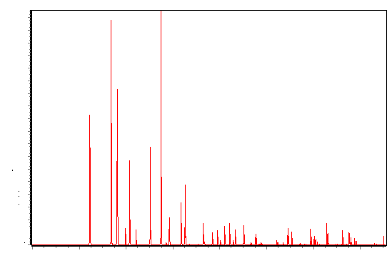

Hello ,
I have a most probably easy to answer question.
For a certain purpose I need just the drawing of the (red) Series/Line, without any (black) Box/Lines around it.
How can I get rid of the black rectangle (or the individual lines, top, bottom, left and right) ?
Thanks and best regards

You can hide Legend, Title, Walls and Axes. Ie:
uses Series;
  Chart1.View3D:=False;
  Chart1.Legend.Visible:=False;
  Chart1.Title.Visible:=False;
  Chart1.Walls.Visible:=False;
  Chart1.Axes.Visible:=False;
  Chart1.Color:=clWhite;
  Chart1.AddSeries(TLineSeries).FillSampleValues;
