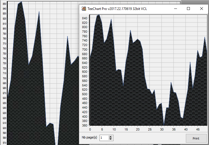

Here it is a screenshot comparing the chart and the pdf your project generates for me with v2017.22:
I'm trying to compare the result with TeeChart v8 but I'm getting an "29100 - Internal GhostScript Error" with GDI and I get a blank pattern in GDIPlus.

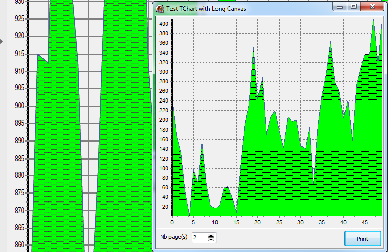

Post by athely » Thu Dec 21, 2017 1:09 pm
Below same example as previous with Delphi XE10.1 & TeeChart 2017.10:
Pattern seems to be streched!
Any idea or workarround?
Anthony
