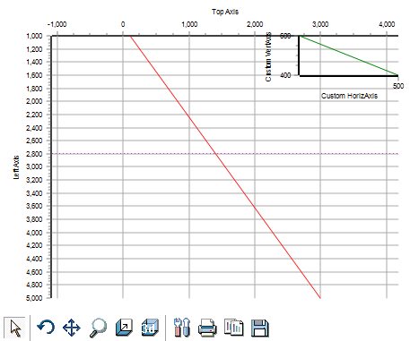

In a Chart, I want to draw curves on two areas (Main Chart and Sub Chart), respectively, and the Sub Chart locates at the Top-Right corner of the Main Chart. I draw the curves on the Main Chart based on the top and left Axes, and the curves on the Sub Chart based on the Custom Axes.
The Scale and Increment of Custom Horizontal Axis are the same with those of the Top Axis, and The Scale and Increment of Custom Vertical Axis are the same with those of the Left Axis. After the curves on the Main Chart are drawn, I should be able to calculate the Height and Width of the Sub Chart according to the Main Chart.

liuxs wrote:1. It is void to get and set the values of axis’s increments. So they are different on the two Charts (I hope they are the same).
I can see the Increments are correct in the editor. Top and Custom 0 axes have an increment of 500, and Left and Custom 1 axes have an increment of 200.
Note the Increment property indicates is used to calculate the maximum number of labels to show without overlapping. If an overlappig is detected, the effective increment will be higher.
You can force the labels using custom labels if you want.
liuxs wrote:2. In the Main Chart and the Sub Chart, I want to draw the Grid Lines only based on its own horizontal and vertical Axes, respectively, without the Grid Lines of another Chart.
Note there's a SubChart Tool that is probably more appropriate for this usage.
In your case, what you call a Sub Chart is actually a pair of custom axes.

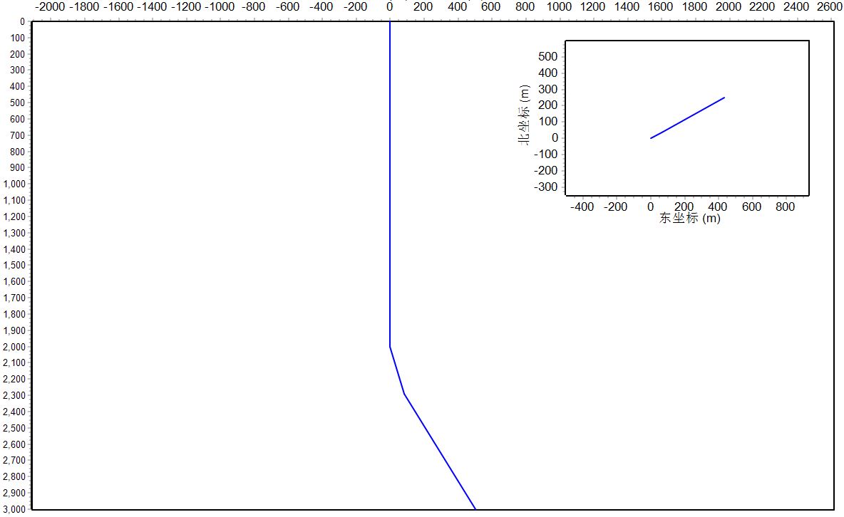

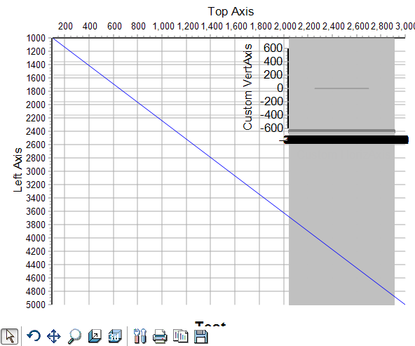

Using the same codes in another program, there are two weird results:
1.Axes Labels do not have the same size (see Fig-1), although I use the same codes to set the Chart and axes properties.
2. When click and zoom in the Sub Chart area, the Curves exceed the range of the Sub Chart area or CustomAxes range (see Fig-2).

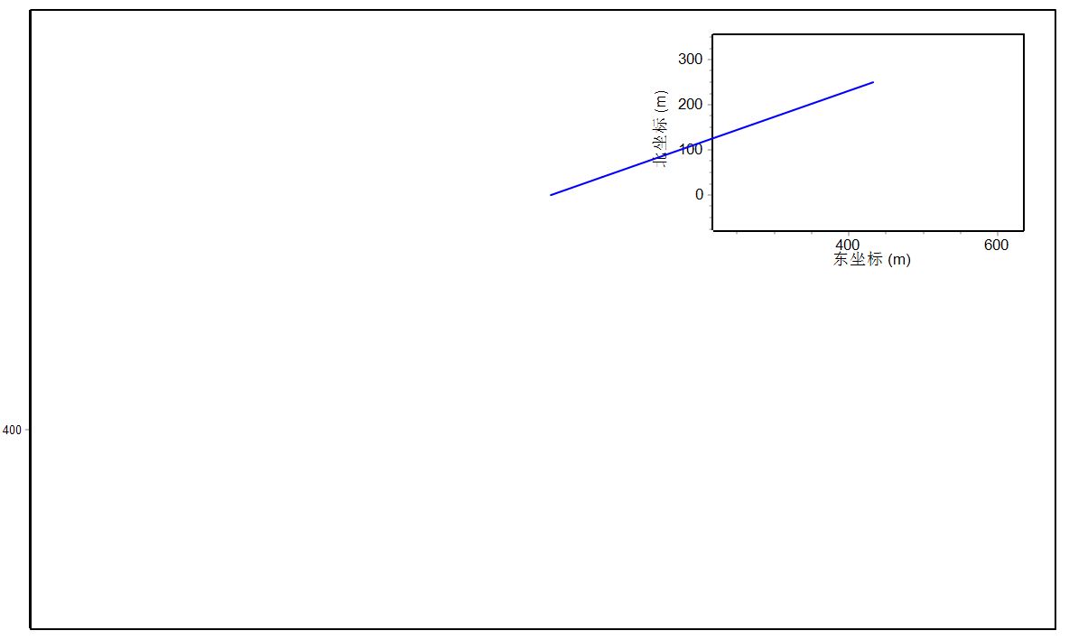

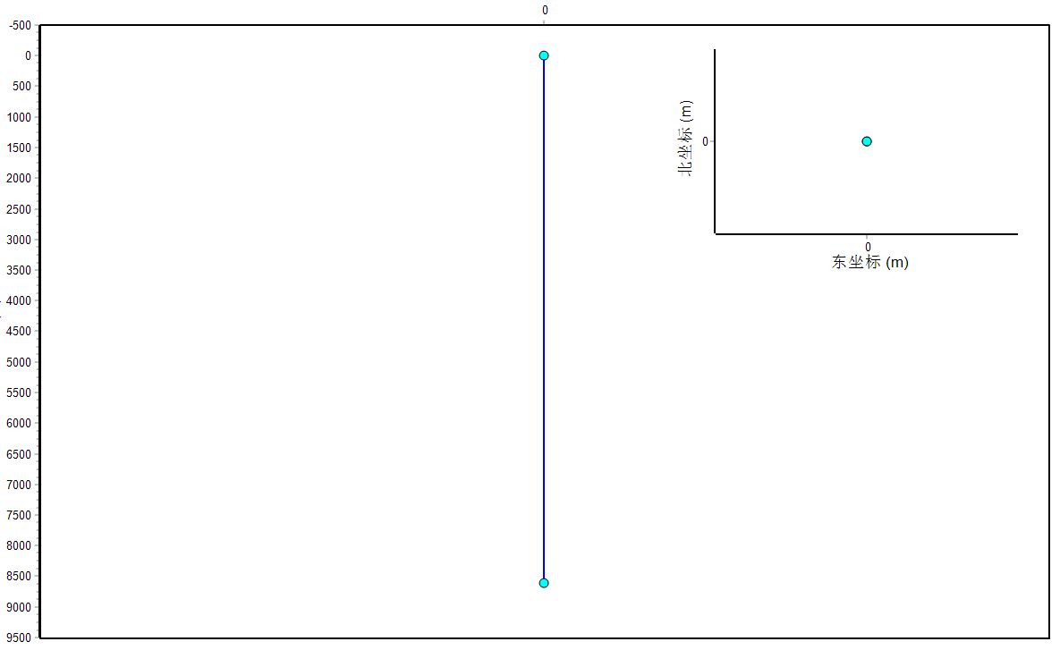

When the Minimum and Maximum of an Axis are equal, there is only one Label on the Axis. That is correct in general. If the horizontal Axis and vertical Axis are isometric, and more than one Labels are required, is it possible to draw a number of Labels on the one-label Axis from the Axis’s Start Position to End Position?
