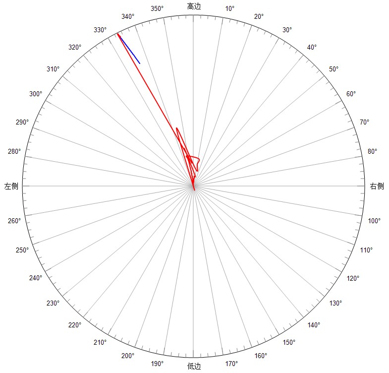

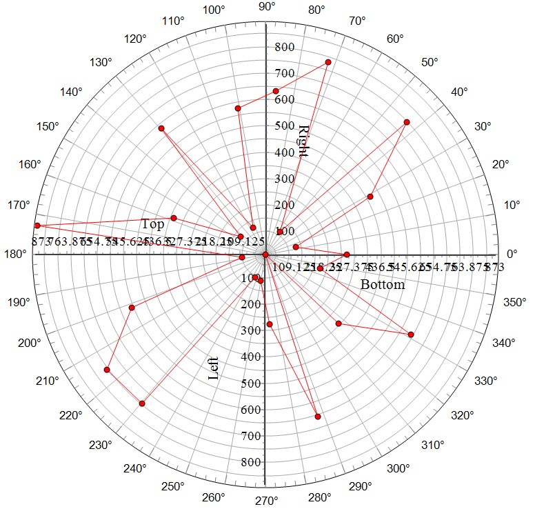

1. A PolarSeries Chart is drawn without radial labels (Fig.1). How to draw the titles and labels of LeftAxis, RightAxis, TopAxis and BottomAxis (Fig.2)?

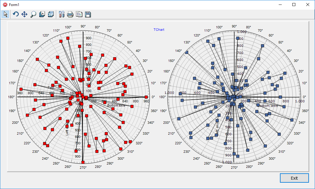

2. Two PolarSeries Charts are drawn in pairs with one TeeCommander (Fig.3), and I can control one of the two Charts alternately by setting the TeeCommander.Panel. Is it possible to synchronously control both of them with one TeeCommander? I want to take the two Charts as one Chart, and zoom, copy, save them together.

Re 1.
The Axis Labels ... Titles, may be shown by adding the text in this way:
The same for Top, Right and Bottom.
Re 2.
A TeeCommander can only control one Chart at a time. It can be changed at runtime by setting the teeCommander.Panel property. To copy zoom settings across charts it may be easiest to do that via the OnAfterDraw eventy of the Chart that the Commander is related to. You can use the Axes' SetMinMax method to copy new Axis Min and Max to the second Chart and can make other modifications in the same way.
To copy and save there are other techniques available, you can 'draw' charts to locations on a common canvas if you wish to drive two charts separately. Alternatively add subcharts to the first chart and the Chart Canvas will control the main chart and subcharts simultaneously for save & copy.
See the Chart Tools, SubChart tool examples in the TeeChart example demo for a visual demonstration.

Re 1.
Chart1.Axes.Left.Title.Text := 'my left axis';
Re 2.

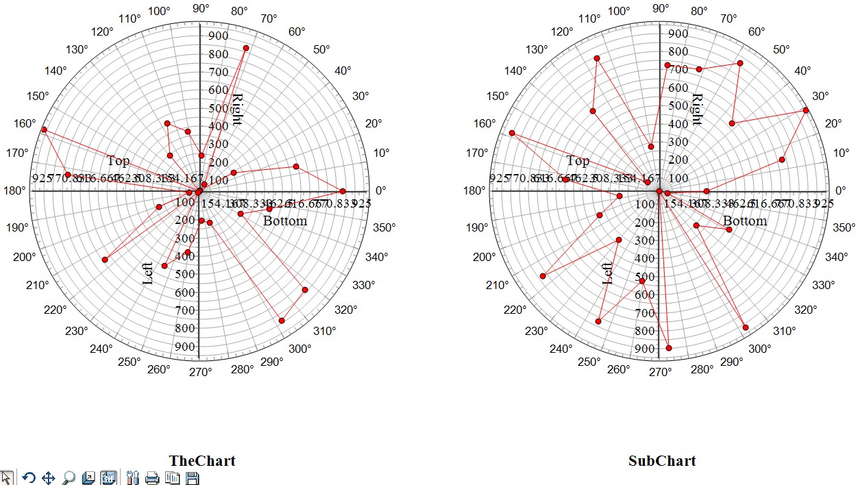

Thank you for your advice. I use the TSubChartTool, and it works. However, the first chart always locates at the center of the Panel, although I try to set its Width, ChartRect.SetLocation and (ChartRect.Left, ChartRect.Right).
I hope that the two charts would be horizontally arranged, do not overlap, and have the same sizes. Could you please help me?

You can set the ChartRect before rendering the Series. For example, using this event for the first Chart Series would move it over to the left half:
The ChartRect has left space for labels (30 pixels each side) within the 500x500 half chart area.
The second series could be set in a subchart as you have done and positioned as discussed here: http://www.teechart.net/support/viewtop ... =3&t=16773. For my test project I added the second Polar Series to the main chart at designtime to make it easier to setup the BeforeDrawValues at designtime, then assigned the Series to the SubChart.

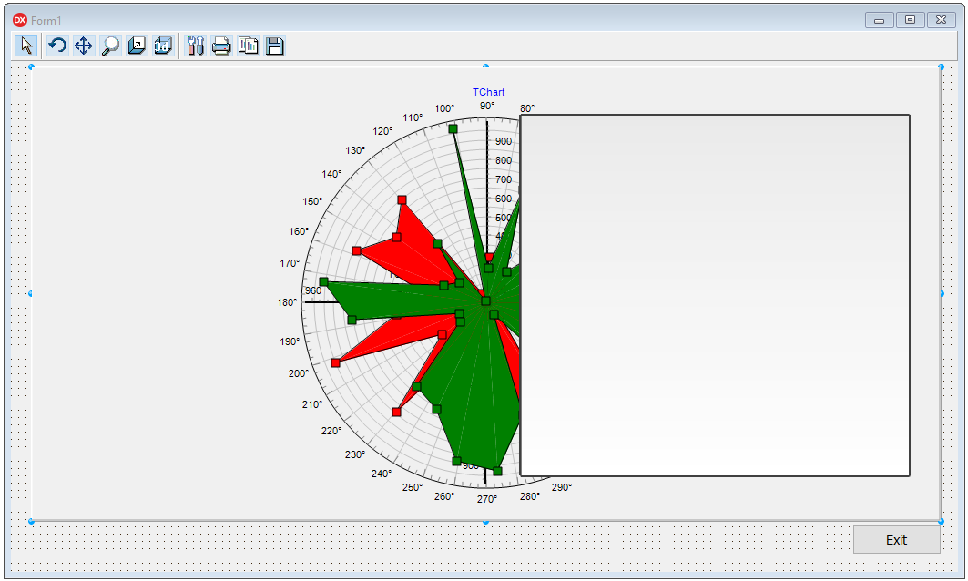

Designtime image with two series in chart plus subchart: At runtime it looks like this: I attach the modified project.
procedure TForm1.Series1BeforeDrawValues(Sender: TObject);
TheChart.ChartRect:=Rect( 30, 30, 470, 470);
