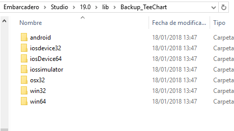

Post by Yeray » Thu Jan 18, 2018 12:51 pm
Rolf Fankhauser wrote:I have chosen Option 1 (much copying because of the subfolder Debug and Release!)
Since the folder structure is respected, you can just cut and paste all the folders one level up:
