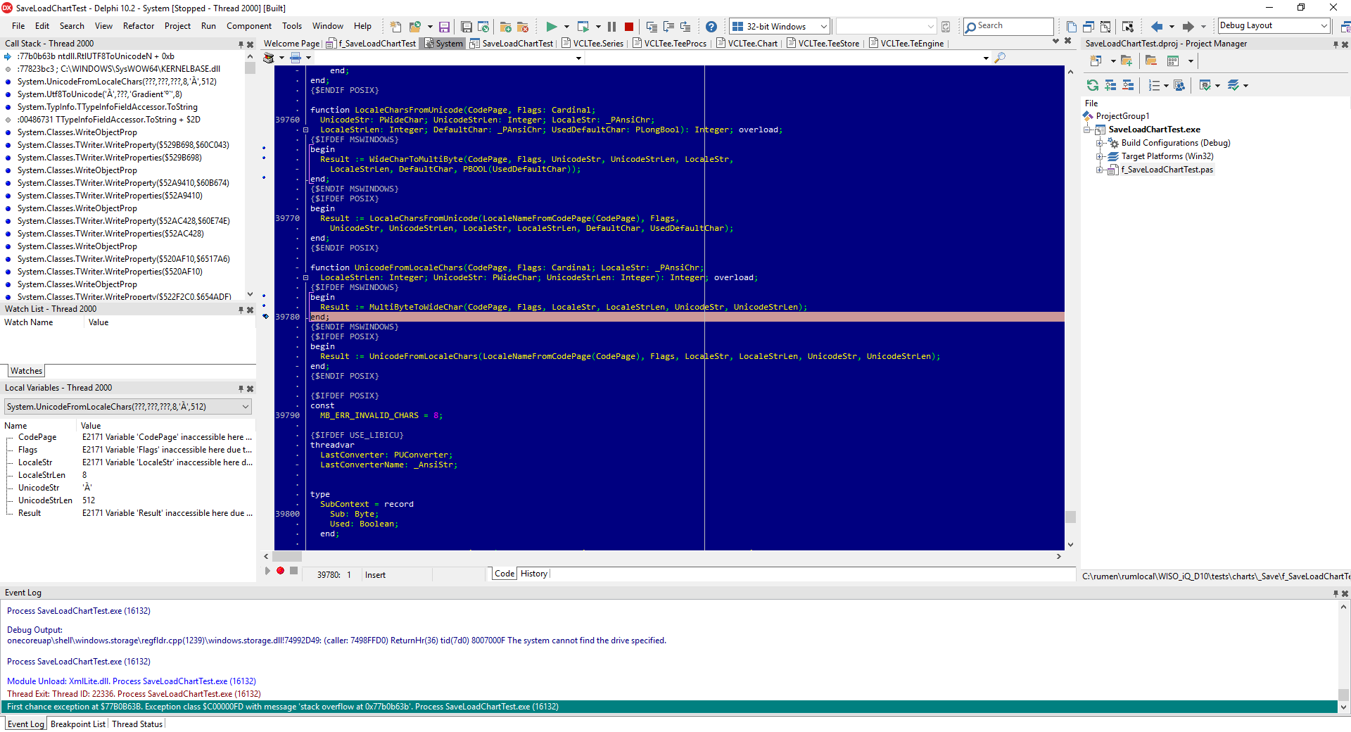

and try to save the chart, I get stack overflow in
function UnicodeFromLocaleChars(CodePage, Flags: Cardinal; LocaleStr: _PAnsiChr;
  LocaleStrLen: Integer; UnicodeStr: PWideChar; UnicodeStrLen: Integer): Integer; overload;
{$IFDEF MSWINDOWS}
  Result := MultiByteToWideChar(CodePage, Flags, LocaleStr, LocaleStrLen, UnicodeStr, UnicodeStrLen);
{$ENDIF MSWINDOWS}

Screen shot of the IDE
