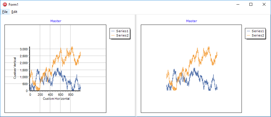

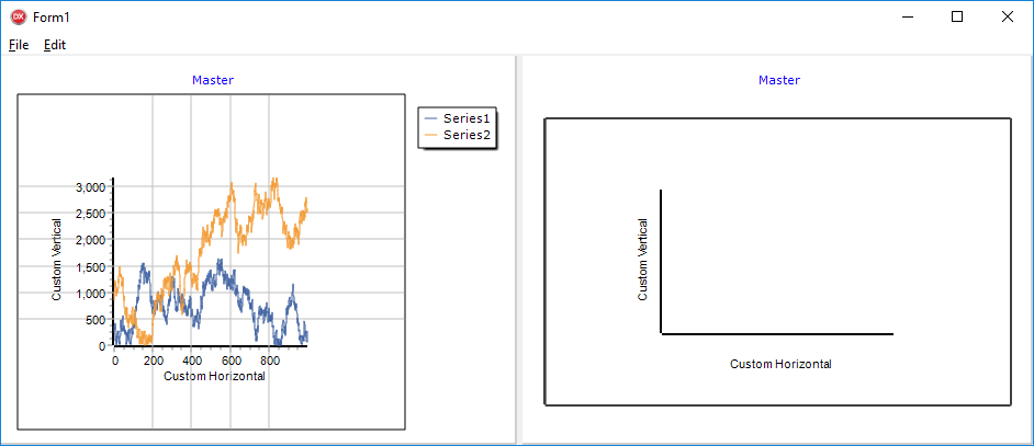

If there are custom axes on a chart, CloneChart does not copy them. The only way to duplicate such chart appears to be Save it to Stream and Load the stream in the new chart.
if Master is the original chart and clone is its duplicate, I get the following results:
Clone.Assign(Master):
  CloneChart(clone, master, self, FALSE):
When I use save to/load from stream, I get proper results. A simple project is attached. Use Edit->Copy(Assign), Edit->Copy(Clone) and Edit->Copy(Stream) to see the effects.

Re: Duplicate chart with custom axes
Post by Yeray » Mon Jan 29, 2018 2:37 pm
This sounds as the very same ticket #780, isn't it?
Post by Yeray » Tue Jan 30, 2018 10:31 am
Hello Roumen,
roumen wrote:It is disappointing that the problem was reported in 2013 and in 2018 CloneChart is not doing what it is supposed to do still...
You are right. I've revised the ticket #780 and just implemented a fix for it.
Since you own the TeeChart sources - and it's pretty simple - you can implement it and (Tee)Recompile them.
At CloneChart method in Chart.pas, add this after the loop where the series are cloned:
procedure CloneChart(const Dest,Origin:TCustomChart; const AOwner:TComponent; ForceManualData:Boolean);
  for t:=0 to Origin.SeriesCount-1 do
      CloneChartSeries(Origin[t],AOwner,Dest);
  // Relink Custom Axes within Destination Series
    if Origin[t].CustomVertAxis <> nil then
       Dest[t].CustomVertAxis:=Dest.CustomAxes[Origin[t].CustomVertAxis.Index];
    if Origin[t].CustomHorizAxis <> nil then
       Dest[t].CustomHorizAxis:=Dest.CustomAxes[Origin[t].CustomHorizAxis.Index];
At the end of the TChartAxis.Assign method in TeEngine.pas, add this:
procedure TChartAxis.Assign(Source: TPersistent);
Begin
  if Source is TChartAxis then
  With TChartAxis(Source) do
  Begin
    Self.FPartnerAxis         :=FPartnerAxis;
    Self.FUsePartnerAxis      :=FUsePartnerAxis;
  end
  else inherited;
