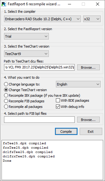

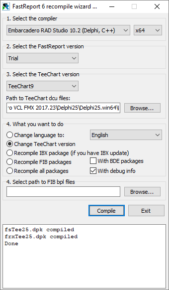

I can build "FastReport 6.0 Tee Components" and "FastScript 1.9 Tee Components" using the recompile.exe tool shipped with Fast Reports 6 Trial version for both win32 and win64.
Then I could drop a TfrxChartObject to a Form in a VCL project, and it compiles without problems in both win32 and win64.
Am I missing anything?

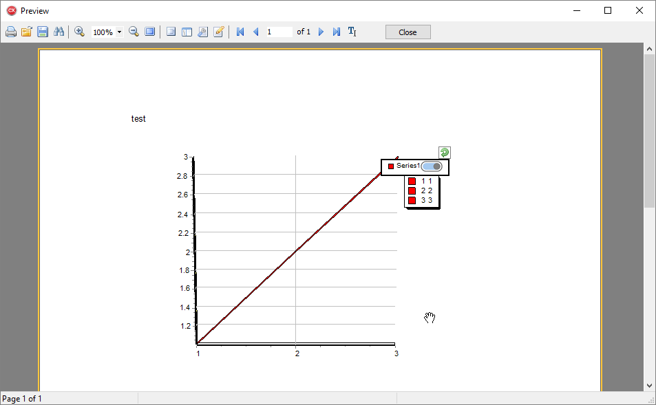

Re: Access violation with TeeChart, Fast Reports with C++Builder
Post by Yeray » Mon Mar 26, 2018 9:23 am
I've been able to run the test application without problems. I just had to copy the fs25.bpl, frx25.bpl, fsTee25.bpl and frxTee25.bpl files, from LibD25 to SysWOW64 and from LibD25x64 to System32 folders.
