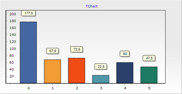

Is there any way in which I can get the axis labels inside the chart rectangle? For example, for the left axis, I like to draw the labels to the right of the axis.
The reason for this is that I wish to develop some graphic components into which I wish to copy the chart rectangle from on off-screen chart.
Thanks in advance for any tips that may help to achive this.

Assigning the series to use right axis and setting a PostionPercent of 100 does the trick.
Here a simple example with a few more tweaks to make it look ok.
uses Series;
  Chart1.View3D:=False;
  Chart1.Legend.Hide;
  with Chart1.AddSeries(TBarSeries) do
    ColorEachPoint:=True;
    FillSampleValues;
    VertAxis:=aRightAxis;
  Chart1.Axes.Right.PositionPercent:=100;
  Chart1.Axes.Right.LabelsOnAxis:=False;
  Chart1.Axes.Bottom.MinimumOffset:=20;
  Chart1.Axes.Right.Grid.Hide;
  Chart1.Axes.Bottom.Grid.Hide;

Works "like a treat"!! Thanks.
