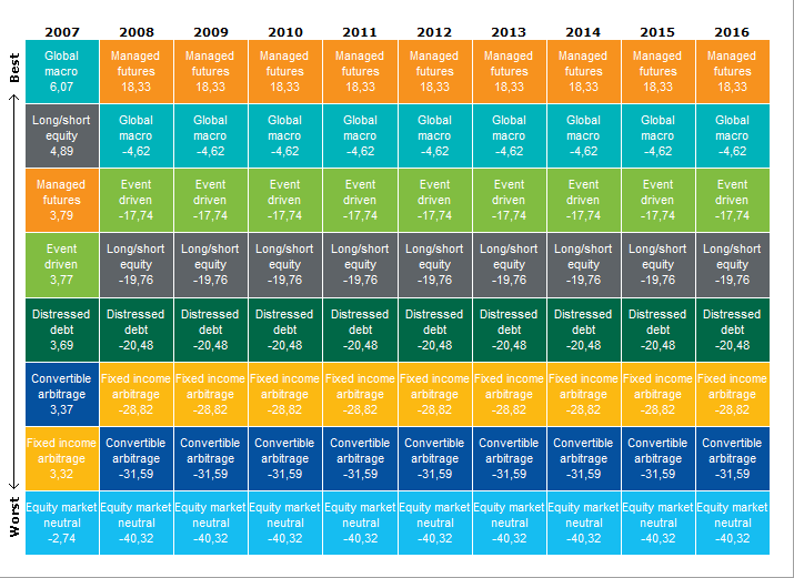

Hi, can Teechart be used to create a "chart" like the image below? Basically just a series of squares with different colors and sorted by a specific value. I'm using Teechart 8.
Thanks in advance for any pointers.

Post by Yeray » Mon Jul 02, 2018 7:58 am
Here a simple example using TBarSeries:

Re: Chart possible with Teechart?
Post by Yeray » Tue Jul 03, 2018 7:20 am
I see in TeeChart v8 the SelfStack MultiBar option doesn't work fine when using multiple TBarSeries, making this approach unusable in that version.
So I would try with a TPointSeries or a TShapeSeries to draw those squares.
If you still find problems with it, we'd need some extra information to try to prepare some example here.
Should all the squares be shown all the time or you'd allow to zoom (making the squares bigger) or scroll them? In the case of allowing to zoom, would you allow to modify their width/height relation?
Post by Yeray » Tue Jul 03, 2018 9:14 am
You could create a class to store all the necessary information in a list. Ie:

This is how it looks with TeeChart v8:
However, resizing the Chart also resizes the squares to rectangles. This isn't a trivial feature.
Post by Yeray » Tue Jul 03, 2018 9:37 am
Yeray wrote:However, resizing the Chart also resizes the squares to rectangles. This isn't a trivial feature.
An option would be to set the scales of the axes at OnResize event, with the MakeIsoAxis. As follows:

Other than years I might show monthly data (e.g. Jan to October), or 3-year periods (2000, 2003, 2006 etc), how would I then need to change the X0/X1 values? (are those coordinates within the chart?)
Post by Yeray » Thu Jul 05, 2018 7:22 am
vinc64 wrote:Other than years I might show monthly data (e.g. Jan to October), or 3-year periods (2000, 2003, 2006 etc), how would I then need to change the X0/X1 values? (are those coordinates within the chart?)
Yes, they are values in the axis scale.
Note the labels in the top axis are directly showing the axis values. I populate the shapes with "X0:=Year-05" and "X1:=Year+0.5" to have those Years in the Top axis.
If you want to show months, you could store them also as integers, populate the shapes with Month-05 and Month+05 and then use the OnGetAxisLabel event to convert those values to month names. Something like this:
procedure TForm1.Chart1GetAxisLabel(Sender: TChartAxis; Series: TChartSeries;
  ValueIndex: Integer; var LabelText: string);
  if (Sender = Chart1.Axes.Bottom) then
    ValueIndex:=StrToIntDef(LabelText, -1)+1;
    if ValueIndex>0 then
       LabelText:=LongMonthNames[ValueIndex mod 12];
Regarding "3-year periods (2000, 2003, 2006 etc)", you could still store the Year and then populate the shapes with "X0:=Year-1.5" and "X1:=Year+1.5".
