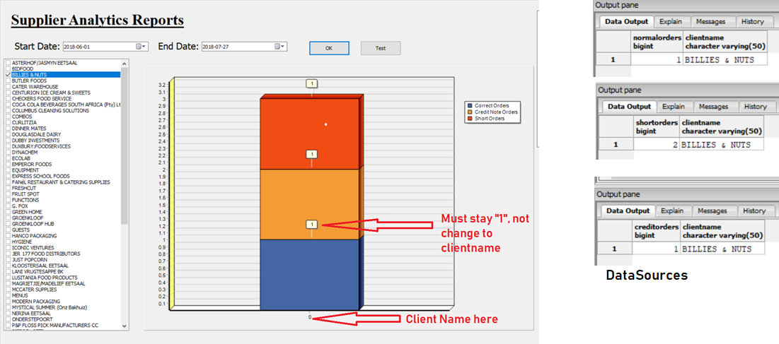

I would like to ask some help on displaying my datasource’s clientname at the bottom of my stacked bar chart. It seems from all the examples that I researched, the bottom chart axis label is set "automatically" by TeeChart looking at the datasource. However I cant seem to get it to work. Below is a picture of what I am trying to achieve. I am using Rad Studio XE2 and VCL forms.
I have attached two images of what I am trying to achieve, and an example of my three datasources (from DB).
I have three series' which I use to build the stacked chart. I have included a picture of each datasource I use for each query.
From my research it seems I can also use the DBChart1GetAxisLabel() to custom set the labels. But I am struggling to understand how to ensure that the correct custom label name is associated with the correct "clientname" from my queries.
Here is a code sample of how I build the charts:

So, just to sum up, is there some setting in my code which I am missing that would show the "clientname" below each stacked bar, or must I use custom labels? If I must use custom labels, I would appreciate some direction on how to ensure that I replace the correct "clientname" from the datasource to the correct ValueIndex in the DBChart1GetAxisLabel?

You could set the XLabelsSource to show the text from the DataSource and then set the series Marks.Style to smsValue to force it showing values instead of showing the labels. Ie:
var ADOQuery1: TADOQuery;
    i: Integer;
  ADOQuery1:=TADOQuery.Create(Self);
  with ADOQuery1 do
    ConnectionString:='Provider=MSDASQL.1;Persist Security Info=False;Data Source=TeeChart Pro Database';
    SQL.Add('SELECT SALARY, LASTNAME from Employee WHERE LASTNAME='#39'Smith'#39);
  for i:=0 to 1 do
    with DBChart1.AddSeries(TBarSeries) as TBarSeries do
      XLabelsSource:='LASTNAME';
      DataSource:=ADOQuery1;
      MultiBar:=mbStacked;
      YValues.ValueSource:='SALARY';
      Marks.Style:=smsValue;
  ADOQuery1.Open;

Thanks a lot! This solved the issue for me.
