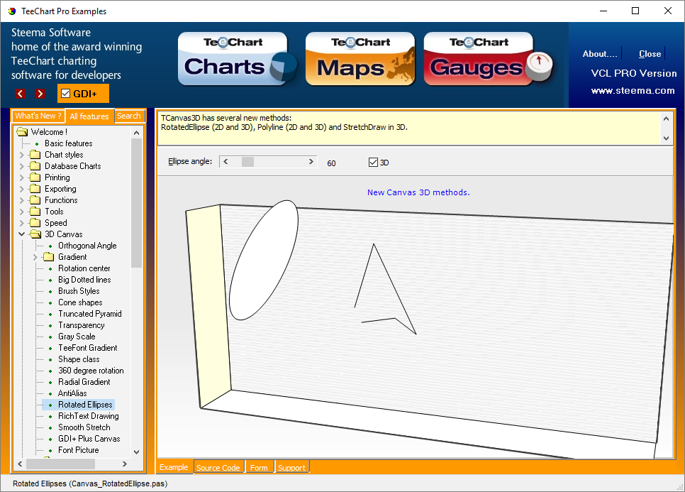

Indeed, there's the RotatedEllipse method to manually draw rotated ellipses. Here it is an example of usage:

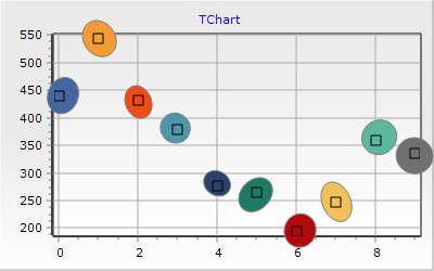

You could use it (ie at OnBeforeDrawSeries event) to draw them behind your point series. Ie:
uses Series, TeCanvas;
procedure TForm1.Chart1BeforeDrawSeries(Sender: TObject);
var P : TPointArray;
    tmpX, tmpY, i: Integer;
  with Chart1.Canvas do
    for i:=0 to Chart1[0].Count-1 do
      tmpX:=Chart1[0].CalcXPos(i);
      tmpY:=Chart1[0].CalcYPos(i);
      Brush.Color:=Chart1[0].ValueColor[i];
      RotatedEllipse(tmpX-Round(10+random*10),tmpY-Round(10+random*10),tmpX+Round(10+random*10),tmpY+Round(10+random*10),0, random*360);
  Chart1.Legend.Hide;
  Chart1.View3D:=False;
  with Chart1.AddSeries(TPointSeries) as TPointSeries do
    ColorEachPoint:=True;
    FillSampleValues(10);
