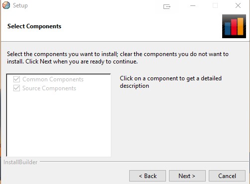

Pls see attached picture SS2.

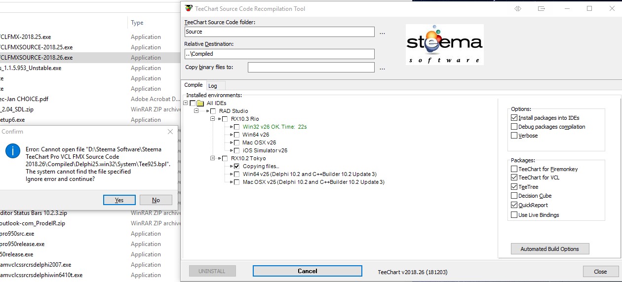

The files are not in the directory when it gets to the copy stage. :-(
Pls see attached picture SS3.

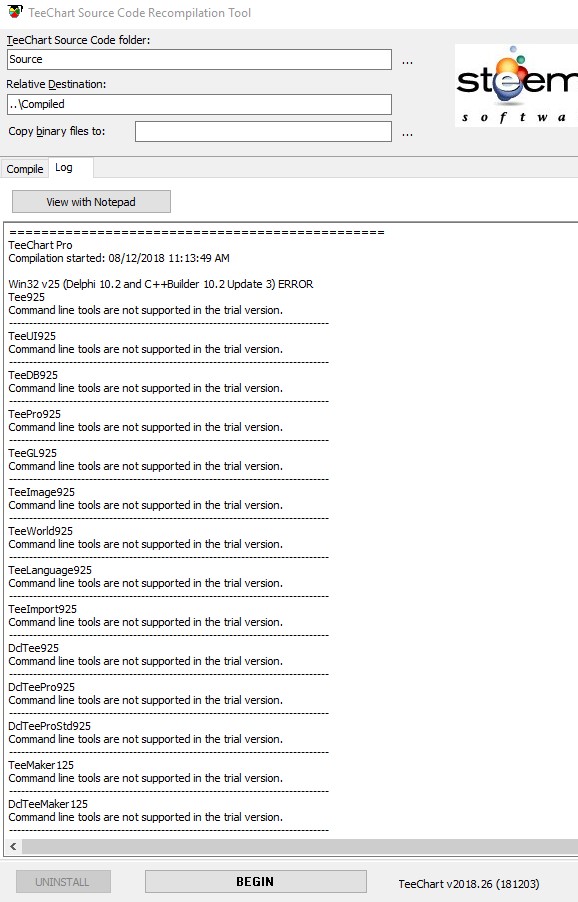

The Log suggests it isn't registered. How can that be??
Pls See attached picture SS4.
The log suggests RAD Studio 10.2 Tokyo isn't registered. If you are you using a RAD Studio trial version, as the error message indicates, you can't run the delphi compiler through the command line. This means you can't use TeeRecompile to compile and install TeeChart Sources. However, if that's your situation, you can still use the TeeChart binary installer, which doesn't need to recompile anything.
