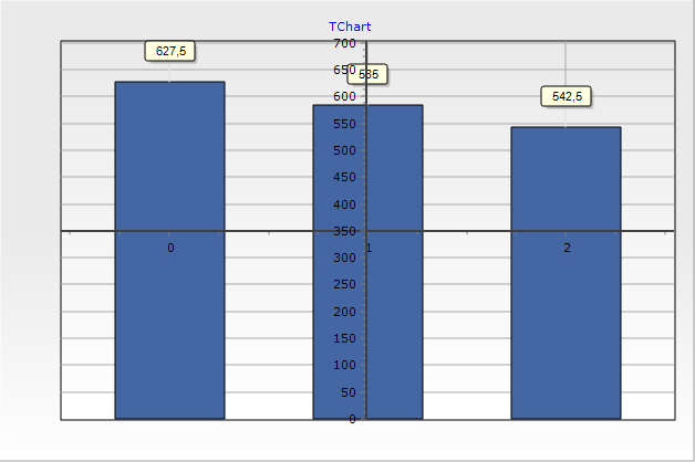

Is there a setting somewhere that allows the axes to be drawn over the series lines, but the grid lines to remain under the series?

You could set the axes to be drawn on top setting DrawBehind to False. Then, you could Hide the Grids and manually draw them at OnBeforeDrawSeries event. Ie:
uses Series;
  Chart1.View3D:=False;
  Chart1.Legend.Hide;
  Chart1.Axes.Behind:=False;
  Chart1.Axes.Left.PositionPercent:=50;
  Chart1.Axes.Left.Grid.Hide;
  Chart1.Axes.Bottom.PositionPercent:=50;
  Chart1.Axes.Bottom.Grid.Hide;
  Chart1.AddSeries(TBarSeries).FillSampleValues(3);
  Chart1.Draw;
type TChartAxisAccess = class(TChartAxis);
procedure TForm1.Chart1BeforeDrawSeries(Sender: TObject);
  Chart1.Axes.Left.Grid.Show;
  TChartAxisAccess(Chart1.Axes.Left).DrawGrids(Chart1.Axes.Left.Items.Count);
  Chart1.Axes.Bottom.Grid.Show;
  TChartAxisAccess(Chart1.Axes.Bottom).DrawGrids(Chart1.Axes.Bottom.Items.Count);
