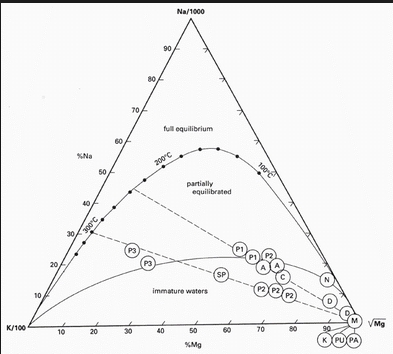

I am trying to create some standard geothermal ternary plots and having difficulty with some aspects. The plot I am trying to emulate is shown here.

4. Are there tools to draw the two curved lines and text (names of regions and temperatures on the upper curved line) on the graph as in the attached image?
I'm afraid the functions in TeeChart only support the regular perpendicular axes. These lines should be calculated and drawn manually at OnAfterDraw event. If you tell us what functions you'd like to use, we can think on the best way to use them.
