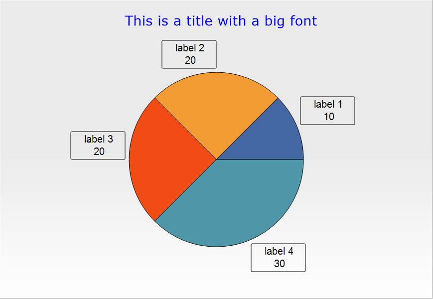

I have a pie series where the marks overlap the caption. Here is a sample:
I am not too sure how to fix it--but spent ~30 minutes in the IDE chart/pie series marks and only got more confused.
I can decrease the font size a bit, but how do I hide the background (via code please).
Can I decrease the pie size a little?
I would also like to hide the background to the marks, but cannot figure that out.
Any other suggestions would be appreciated.

EdDressel wrote:
Fri Jun 21, 2019 3:57 pm
You can call "Marks.Brush.Clear".
You can manually set a CustomXRadius. Since the Cirlced property is set to true by default, you don't need to set the CustomYRadius.
Ie:
uses Series;
  Chart1.View3D:=false;
  Chart1.Legend.Hide;
  Chart1.Title.Text.Text:='This is a title with a big font';
  Chart1.Title.Font.Size:=20;
  with TPieSeries(Chart1.AddSeries(TPieSeries)) do
    AddPie(10, 'label 1');
    AddPie(20, 'label 2');
    AddPie(20, 'label 3');
    AddPie(30, 'label 4');
    Marks.Font.Size:=15;
    Marks.Style:=smsLabelValue;
    Marks.MultiLine:=True;
    Marks.Brush.Clear;
    CustomXRadius:=100;
You could also write your own algorithm to move the marks, you could use the DragMarks tool to let the user move the marks manually, or you could set them to be inside the pie setting PieMarks.InsideSlice to True.
