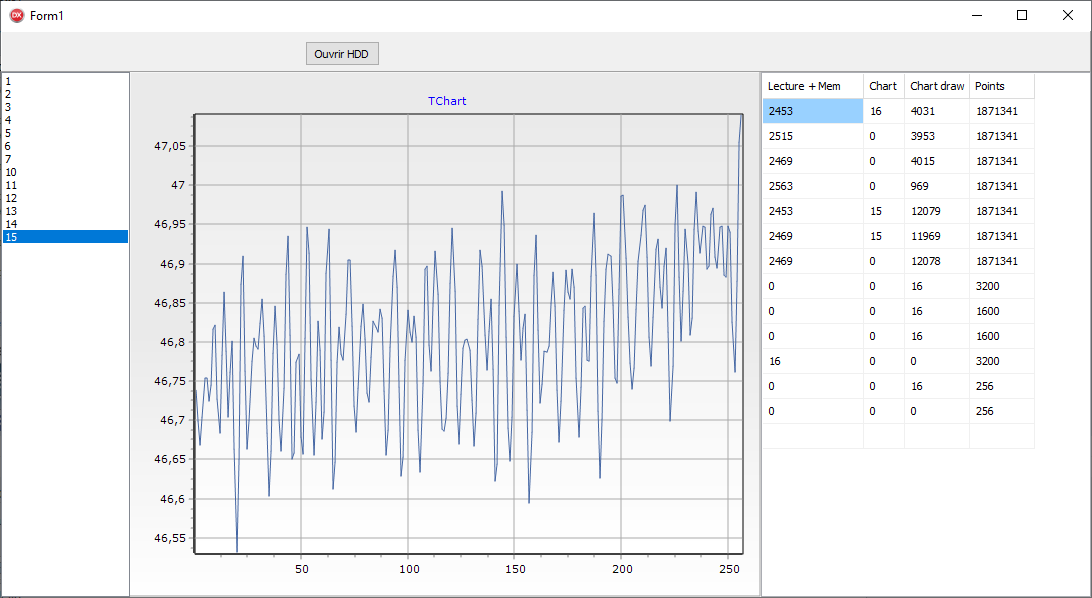

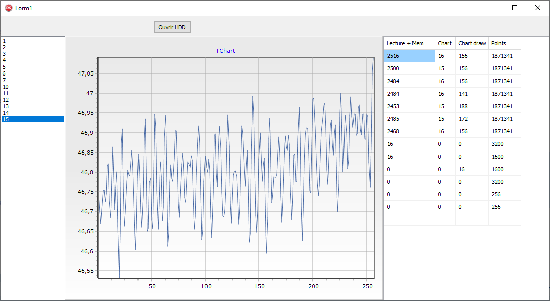

Here the results I get:
- Drawing all the points (DrawAllPoints=True):
- Using daMinMax algorithm:
- Using daFirst:
We can see that, for the given data and configuration, the daMinMax algorithm doesn't improve the drawing speed, but the daFirst algorithm has a significant impact on the drawing speed.
