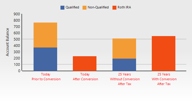

In the image below, labels ("A") are being dropped because the chart is not wide enough. I have a couple of questions:
1) I remember there is a margin setting somewhere that increases the likelihood that they will be drawn (years ago support told me about it). Do you know what that is?
2) Also, is there any way to reduce the amount of space on the left and right ("B")? I would think would increase the chances of the labels being included, right?
Thank you
Ed Dressel

Indeed setting thinner bars seems to help:
  for i:=0 to chrRothConvert.SeriesCount-1 do
    TBarSeries(chrRothConvert[i]).BarWidthPercent:=50;
EdDressel wrote:
Thu Oct 17, 2019 12:50 am
In your dfm I see you've set the bottom axis MinimumOffset and MaximumOffset to 48. Removing that reduces that space and you don't even need to set the BarWidthPercent to 50 to see all the labels:
