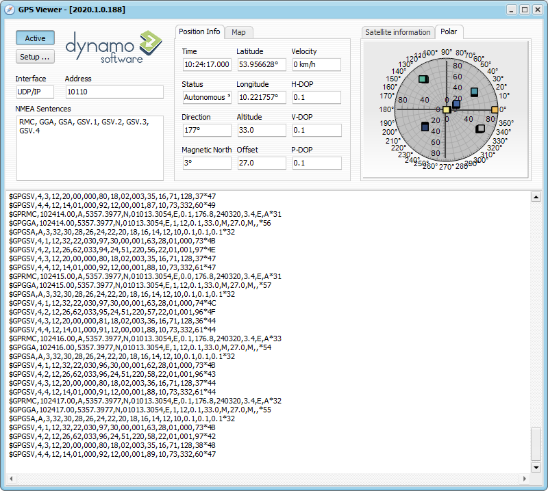

Hello to everyone! I would like to display the „satellites in view“ information from GPS data in a polar chart.
The information i have is:
  • The satellite ID (integer)
  • The signal strength (integer)
  • The azimuth angle (0..360 degrees)
  • The elevation angle (0..90 degrees)
I have a TChart on my VCL delphi form and i add a TPolarSeries programatically for each satellite.
With each TPolarSeries i do a AddPolar(AzimuthValue, ElevationValue).
This works basically with two odd things:
  • The Zero Azimuth Value starts at 3 o’ Clock position and increases counter clockwise. I would like to have the Zero Value at 12 o’ clock position and increments in clockwise direction.
  • The elevation Angle has its Zero Position in the center of the polar Chart. The maximum up to 90 degrees increase automatically at the outside of the chart. I would like to have the value of 90 degrees (Zenith) in the center of the chart and the value of 0 degrees on the outside of the chart.
In addition to the points above i would like to change the line thickness with every AddPolar to reflect the signal strength. Also i do not want to see the filled area and i do not want do see marks for every plot. Maybe a mark for the last plot... Basically i want to see the tracks that the satellites ‚draw‘ into the hemisphere. A nice to have would be a label at the last position for each track/series that would show the id of the given satellite.
Thanks alot for your help!
Jens

The first part of the question:
You can set the "Rotated" property (in the Circled tab of the Series in the Editor) to 90º to bring 0º to the vertical.
You'll see a Clockwise property in the Labels tab of the Series in the Editor to change the direction the labels.
I'll take a look at the other part of your question.
Marc Meumann
Posts: 1319
Location: Girona
Re: How to use a polar chart for astronomical appliance
Post by Marc » Thu Mar 26, 2020 11:22 am
Re.
These features are not possible with the current version of the TPolarSeries.
You can regulate the fill transparency:
eg.
Series1.Transparency := 40; //%
or just make it non-visible:
eg.
Series1.Brush.Style := bsClear;
Could do that via the Series Mark event:
eg.
procedure TForm14.Series1GetMarkText(Sender: TChartSeries; ValueIndex: Integer;
  var MarkText: string);
 if (ValueIndex <> Sender.Count-1) then
   MarkText := '';
