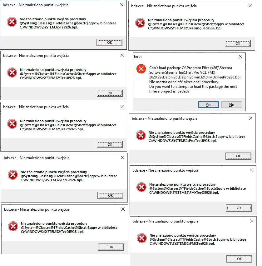

I have never used this package and cannot install it for 10.3 RAD.
1. Now installation of the package is without errors

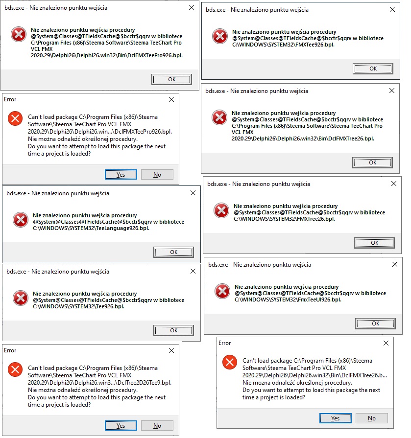

2. When I try to run RAD it gives me 20 errors - screenshots attached starting from the first error
What should I do to be able to use this package ?
Thanks for replies.
Re: Cannot install for RAD 10.3.1 - errors
Post by Yeray » Mon Apr 06, 2020 5:12 am
Give it a try at a previous version, like 2019.27 or 2019.28. Note we always build TeeChart binary versions with all the updates installed in the IDEs, so that's what we recommend.
