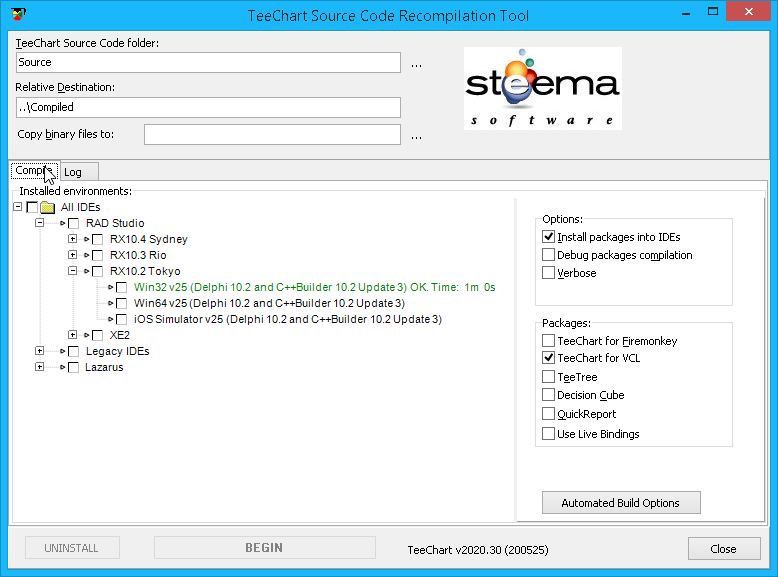

Did you run TeeRecompile with "Install packages into IDEs" checkbox selected? Did it end with all the RX10.2 Tokyo items in green (specially the win32 since this is the one that includes the design-time package)?
Yes I did. Everything was green.
I only compiled / installed the TeeChart for VCL packages (see attached screenshot).
There was no error message in the log file:
(see attachment TeeRecompileLog.zip)
