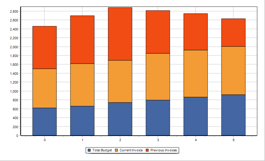

Here a simple example showing three stacked bars with several values:
var
  i: Integer;
const
  titles: array[0..2] of string = ('Total Budget', 'Current Invoice', 'Previous Invoices');
  for i:=0 to 2 do
    with TBarSeries(Chart1.AddSeries(TBarSeries)) do
      Title:=titles[i];
      FillSampleValues;
      MultiBar:=mbStacked;
      Marks.Hide;
  Chart1.Legend.Alignment:=laBottom;

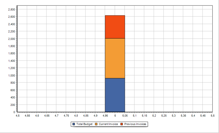

Here the same chart after calling that code to only show the last bar:
