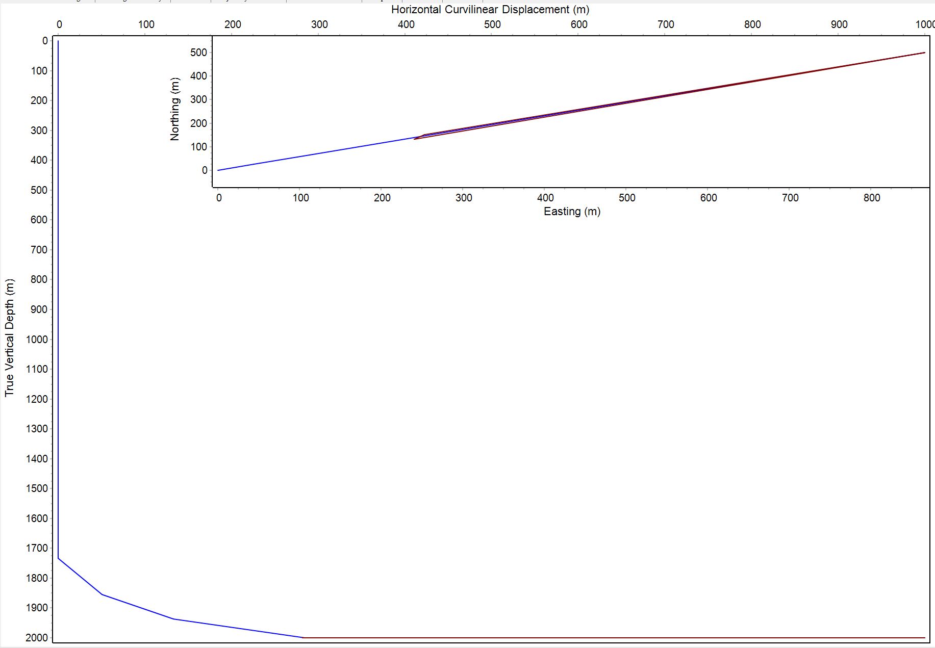

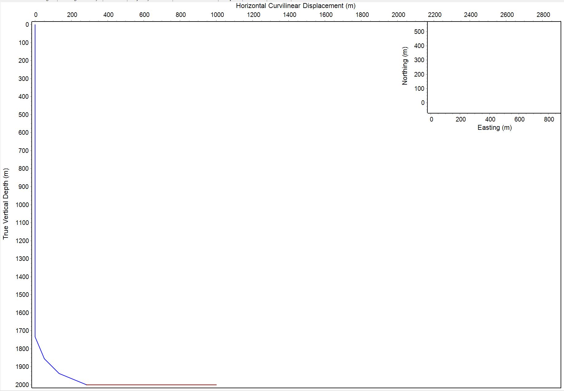

When SubChart changes its position and size, the Series disappear.
The program works well in Windows 7, but it goes wrong in Windows 10.
Can't figure out what the problem is?

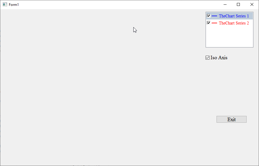

Based on your code, I wrote a test program and it does not work. Please find attached.
Would you like to help me find out what the problems are?

Is this what you would expect?
Of Course Not. I corrected the code, and the chart appears.
Before I start spending the time to look at the code, would you please be so kind as to tell me what you expect the app to do, and where you think the problems are?
I developed an application before, and there were some problems on SubChart’s position and size. I extracted the main code from the app, modified it by referring to your code, and wrote this test app.
Problems are as follows:
1. SubChart does not show its Series.
2. Axis Scales of TheChart and SubChart are not equal, respectively.
3. Although TheChart and SubChart use the same functions, they have different properties. e.g. the Font and Size of Axis Title and Axis Label.

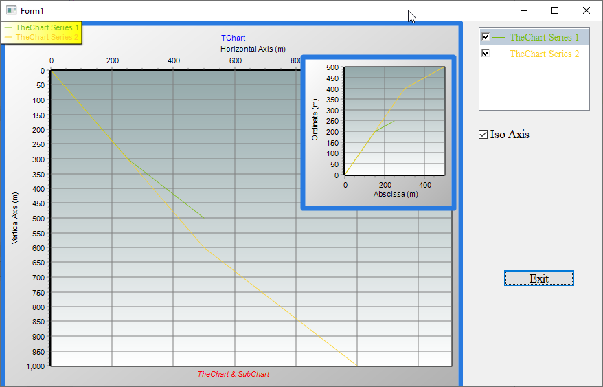

I've made the following changes:
          {with SubChart do
              CustomChartRect := true;
              ChartRect := TeeRect(SubLeft, SubTop, SubRight, SubBottom);
            end; }
          SubChart.Top:=SubTop;
          SubChart.Left:=SubLeft;
          SubChart.Width:=SubRight-SubLeft;
          SubChart.Height:=SubBottom-SubTop;

and these changes give me:
The first changes addresses your first point, and corrects the positioning of the SubChart. The second change addresses your third point and homogenizes Chart display characteristics by the application of a theme to both charts. I'm not sure about your second point, as the TheChart and SubChart contain series with different data, and so will show different axes label values.

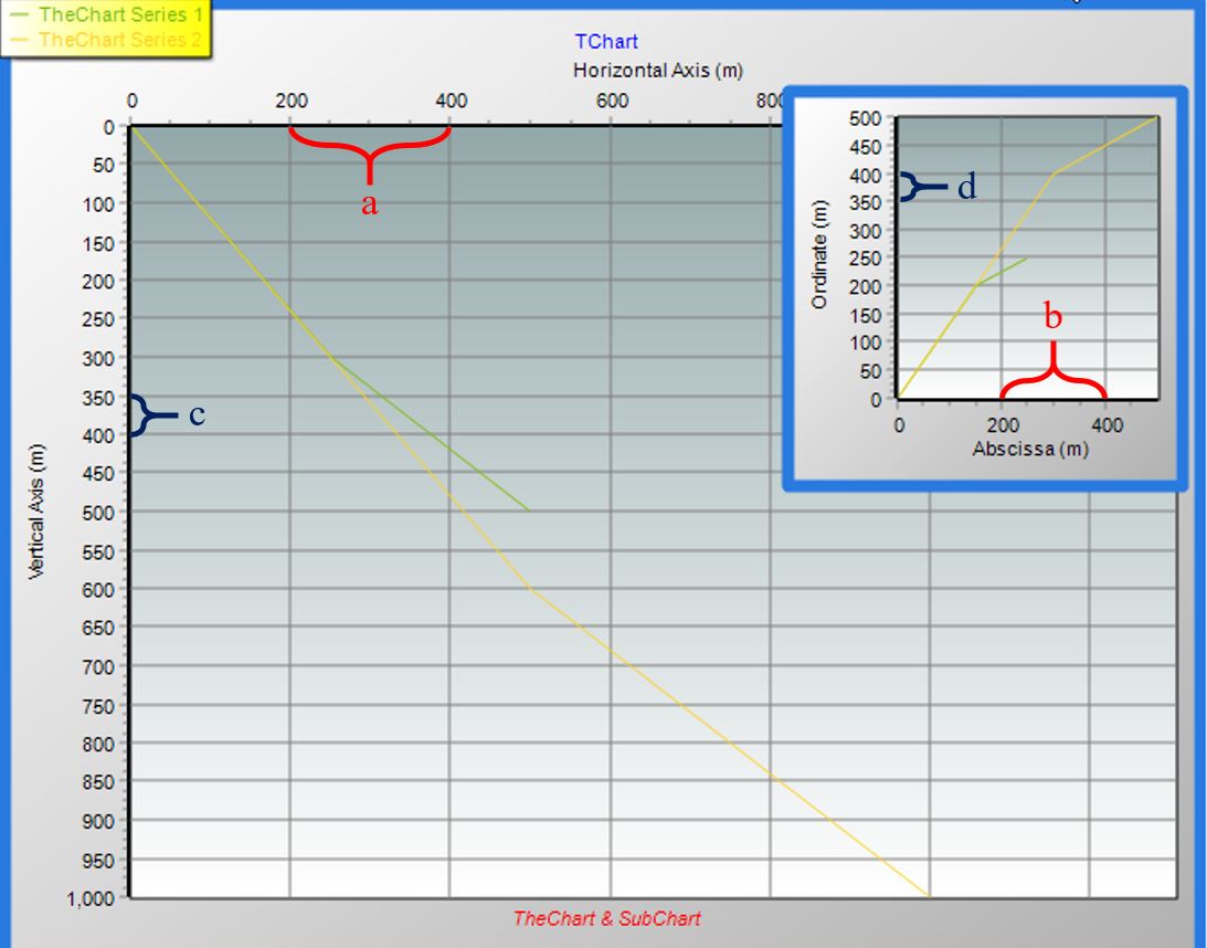

I'm not sure what you mean exactly by 'proportional scales', but the way I understand it would be to add something like this (but not necessarily in this particular place in the code):
What I’m trying to achieve is for the SubChart to have the same scales as TheChart. For example, in the case of the image attached, have the length of a and b to be exactly the same, and the length of c and d to be the same, since they represent the same number of units.
Re: SubChart’s Series disappear
Post by Christopher » Mon Aug 10, 2020 7:51 am
xsLiu wrote:
Sun Aug 09, 2020 4:19 am
Just to get the issue clear in my mind, if that's okay - in the image you post the two axes already have the same scales (an interval of 50 units on the left axes, and an interval of 200 units on the top and bottom axes), so I think you must be referring to the *pixel length* between, say, 350 and 400 or 200 and 400 on the different axes - is that correct?

Post by xsLiu » Wed Aug 12, 2020 11:52 am
Yes, that’s correct.

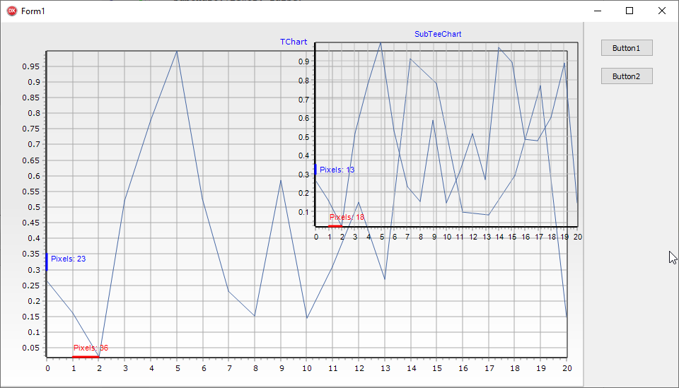

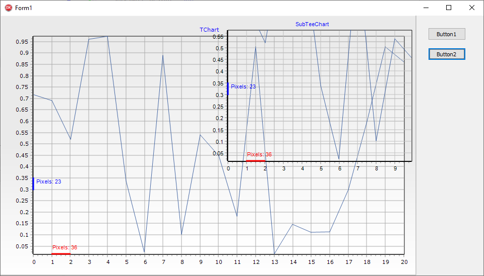

Okay - for clarity I've produced a new unit which attempts to make axes increments the same pixel length for both Chart and SubChart:
unit ChartTest;
interface
uses
  Winapi.Windows, Winapi.Messages, System.SysUtils, System.Variants, System.Classes, Vcl.Graphics,
  Vcl.Controls, Vcl.Forms, Vcl.Dialogs, VclTee.TeeGDIPlus, VCLTee.TeEngine,
  Vcl.ExtCtrls, VCLTee.TeeProcs, VCLTee.Chart, Vcl.StdCtrls, VCLTee.TeeWorldSeries, VCLTee.Series,
  VCLTee.TeeURL, VCLTee.TeeSeriesTextEd, VCLTee.TeeSubChart, VCLTee.EditChar;
type
  TForm1 = class(TForm)
    Chart1: TChart;
    Button1: TButton;
    Button2: TButton;
    procedure Button1Click(Sender: TObject);
    procedure Button2Click(Sender: TObject);
    procedure Chart1AfterDraw(Sender: TObject);
    procedure SubChartAfterDraw(Sender: TObject);
  private
    SubChartTool: TSubChartTool;
    SubChart: TChart;
  public
    { Public declarations }
var
  Form1: TForm1;
implementation
{$R *.dfm}
     VCLTee.EditChar.EditChart(Self, Chart1);
procedure TForm1.Button2Click(Sender: TObject);
var charRect, subRect : TRect;
    pixelXUnit,pixelYUnit:Double;
    subBottomMax,subLeftMax:Double;
    charRect:=Chart1.ChartRect;
    subRect:=SubChart.ChartRect;
    pixelXUnit:=(Chart1.Axes.Bottom.Maximum-Chart1.Axes.Bottom.Minimum)/charRect.Width;
    pixelYUnit:=(Chart1.Axes.Left.Maximum-Chart1.Axes.Left.Minimum)/charRect.Height;
    subBottomMax:=pixelXUnit*subRect.Width;
    subLeftMax:=pixelYUnit*subRect.Height;
    SubChart.Axes.Bottom.SetMinMax(Chart1.Axes.Bottom.Minimum, subBottomMax);
    SubChart.Axes.Left.SetMinMax(Chart1.Axes.Left.Minimum, subLeftMax);

Running this gives me:
and then clicking on Button2 gives me:
xsLiu
Posts: 33
Joined: Wed May 22, 2019 12:00 am
Post by xsLiu » Thu Aug 13, 2020 1:28 am
Yes, it works well.
If Charts have Margins (MarginTop, MarginBottom, MarginLeft, MarginRight) and Axes have Offsets (MinimumOffset, MaximumOffset), how to modify the code ?
Thanks a lot.
