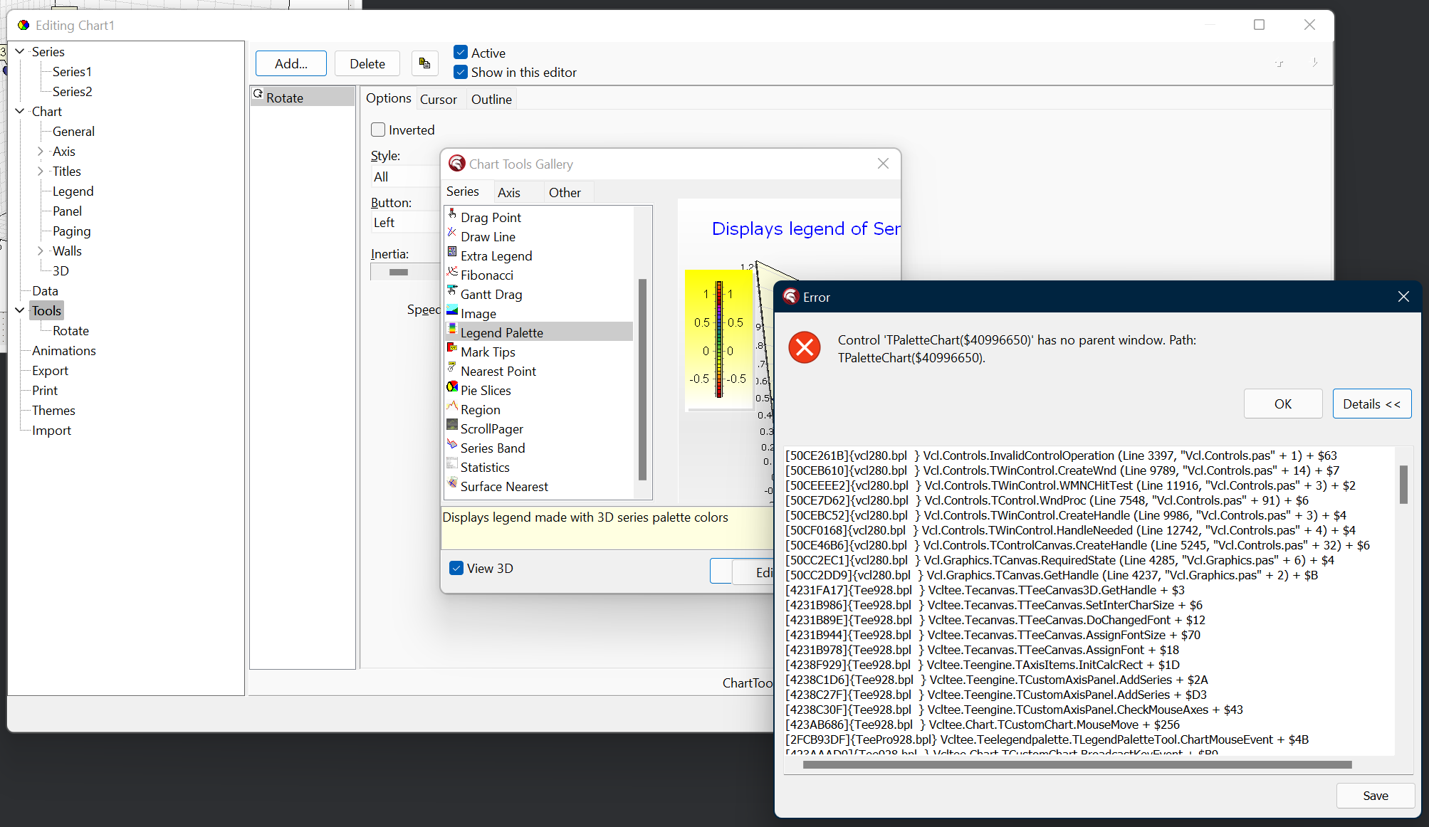

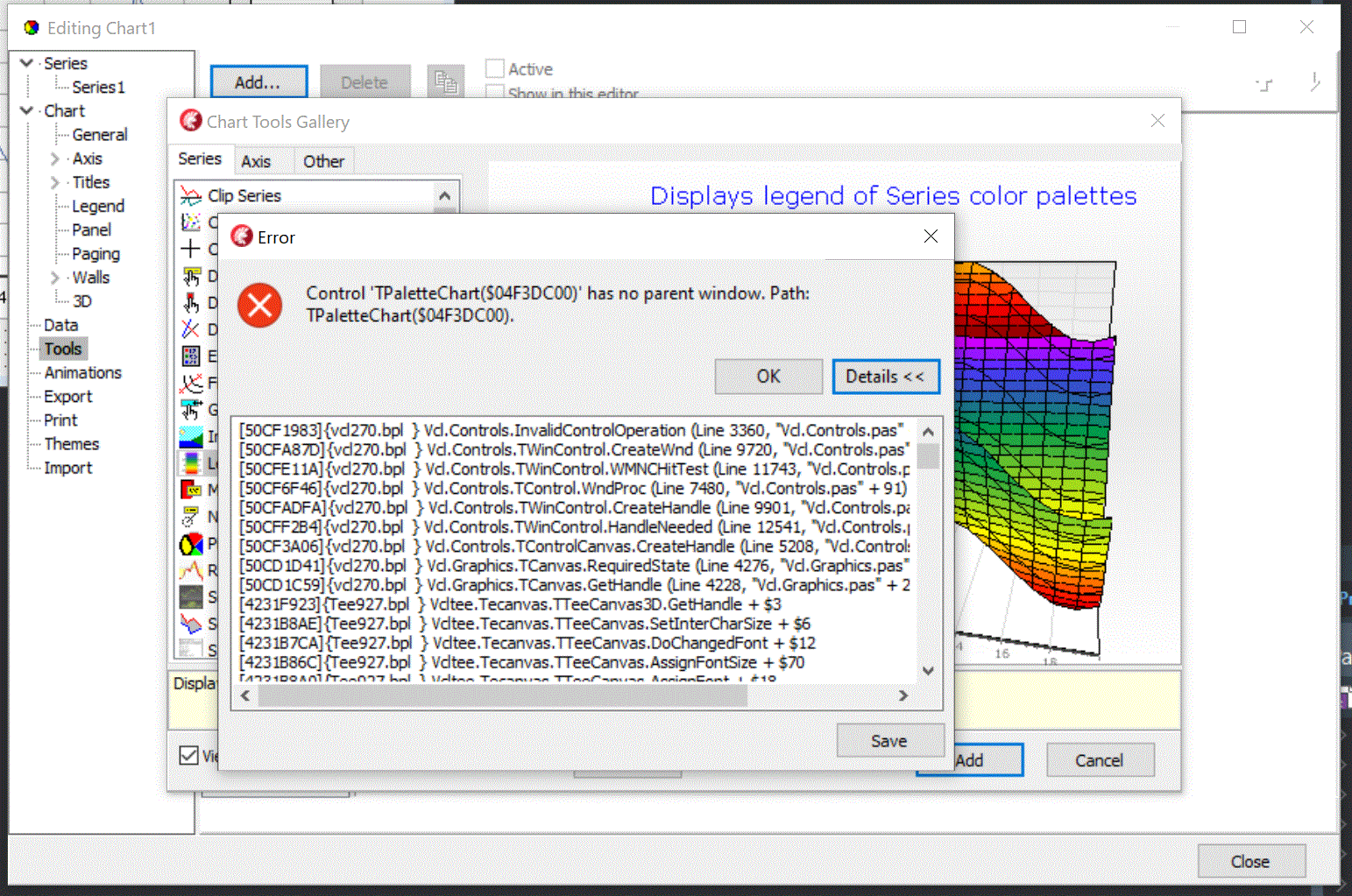

After 2 years, a new fresh Delphi 11 installation and fresh TeeChart installation (latest source code) I still cannot use this tool.

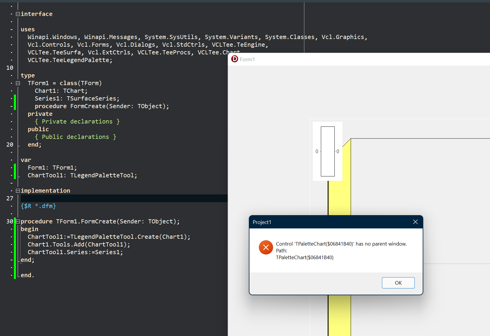

var ChartTool1: TLegendPaletteTool;
  ChartTool1:=TLegendPaletteTool.Create(Chart1);
  Chart1.Tools.Add(ChartTool1);
  ChartTool1.Series:=Series1;

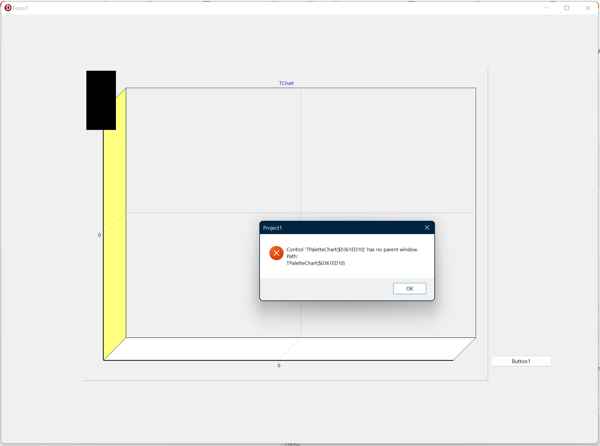

... once the mouse enters the chart area the same happens

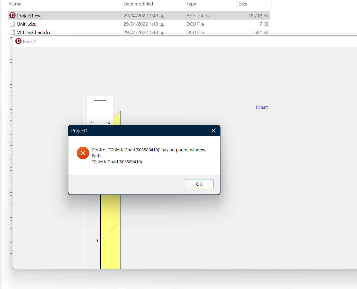

No problem, as I suspected the error is still here! Now what?! :shock:
