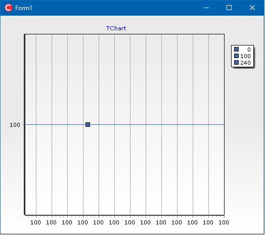

How can i limit chat zoom with the mouse?
Then I zoomed about 24 times, I have only horizontal line. If i try to zoom in again only one point remains. Line can be vertical as well.
First image - test line on chart

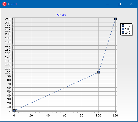

Secons - line after 20+ zooms

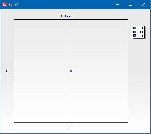

Third - the last zoom
Re: Strange zooming behaviour
Post by Yeray » Fri May 07, 2021 4:23 pm
You can use OnZoom event to save the axes scales every-time the use zooms. Then, you can add a condition at the same event restoring the last axes scales that passed the condition.
